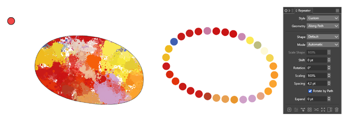

    Color sampling with individual path / paths with the "Along Path" option in the Repeater
    8 Posts 2 Posters 39 Views 2 Watching
      Subpath
      I don't know if the "Along the path" option was intended to allow you to sample colors
      from an image file using the "Background Content" Colorize option. At least it works
      if you create a clipped path ...
      But it would be great if the "Along the Path" option in the repeater could also sample colors
      from an image file with an open path. The current limitation to a clipping path unnecessarily
      restricts the possibilities, in my eyes.
      Something like this does not work

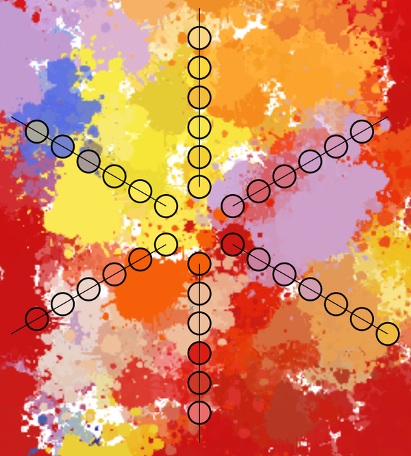

      This and a little more are possible in Paragraphic.
      So just for inspiration: Here are some examples from Paragraphic.
      Dont know if something like this could be work in VS but in Paragraphic it works even with
      multiple paths and vector objects along symmetry paths.
      Here a Video how to create this in Paragraphic
      I created also a Video here how to do this in Paragraphic

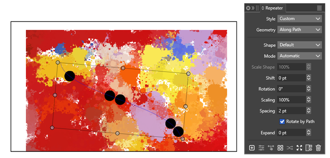

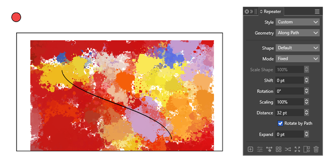

        VectorStyler @Subpath
        @Subpath This might be a bug actually, as it should sample the colors
        Can you send me the VS file by email?
        S 2 Replies Last reply Reply Quote 1
          Subpath @VectorStyler
          ah, ok
          I will send you a file
            The file has been sent.
              @Subpath This will not work for the Along Path repeater, because the object with the repeater does not have a backdrop.
              But the effect can be achieved, by using a Region colorizer, and clipping the image into a rectangle that covers the size of interest.
              I will send in email the example.

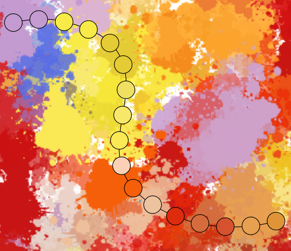

                    After experimenting a bit with the region option for color sampling,
                    I have to say that it doesn't really convince me at the moment.
                    The results simply aren't that predictable.
                    I find using "Along Path" in conjunction with a clipping path to be more
                    predictable— even if you might have to cut out the desired part later on.
                    Here a pic
                    As for color sampling, as it is by now i find "Paragraphic" more useful and easier to work with.
                    It would be great to see improvements in this area in future versions of Vectorstyler, as this
                    method offers interesting possibilities for coloring vector object designs and serves as a nice
                    way to create compelling color palettes.
