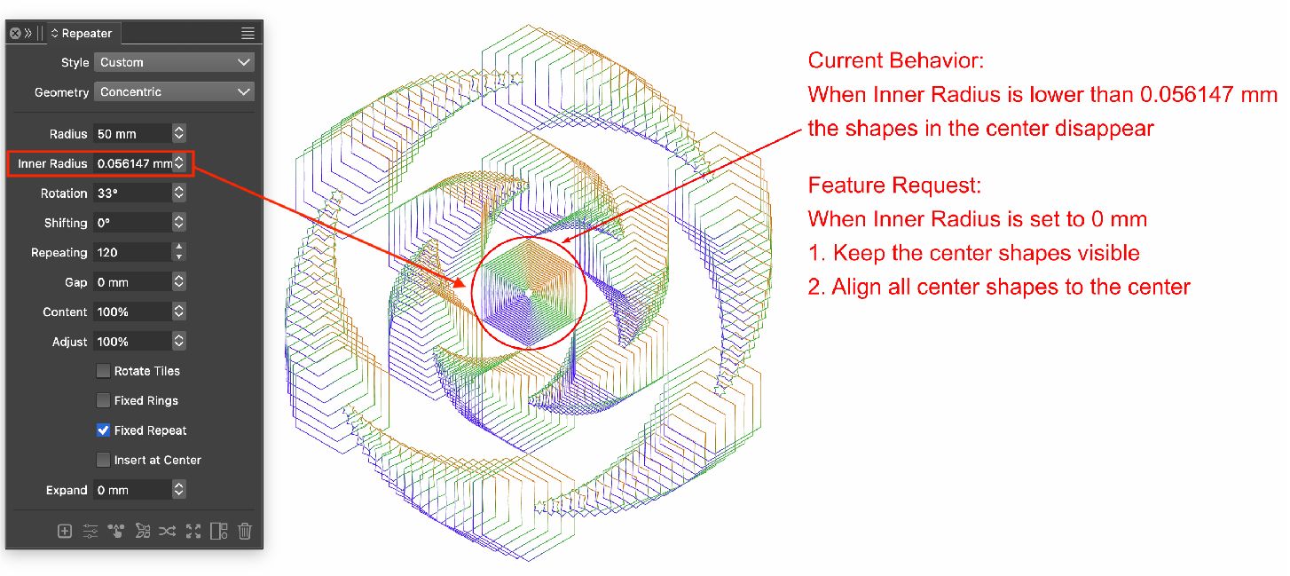

        Regarding the needed improvements for the Inner Radius value, please see the screenshot
        Repeater Concentric - Inner Radius.vstyler
          VectorStyler @Li Xiao
          @Li-Xiao I will try to add these.
