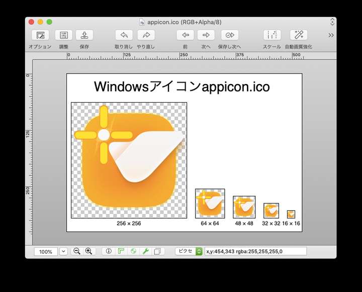

    b) (256, 64, 48, 32, 16)
    /Applications/VectorStyler.app/Contents/vector/data/resources/appicon.ico
    (fig. Copied from Resources)

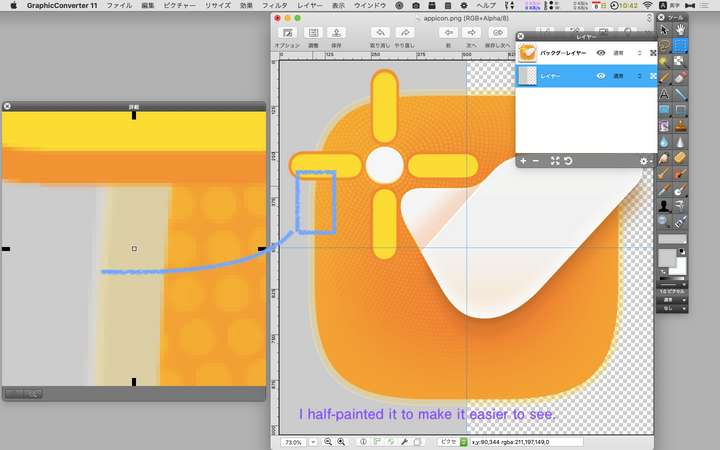

    II) First, the factor
    The icons look fuzzy because of the icon design. The originals must have been created in VS. The resources are images.
    Main factors
    1. Appearance of the outer corner R-frame: blur, transparency, etc.
      When the blur of the frame overlaps with the background, it appears to stick out or false color is generated.
    2. Inner orange dot pattern and gradient.
      The image has lost its original form due to image interpolation.
    Solution to 1
    Change blur to solid.
    Solution to 2
    If you want to make use of the current design, create a dot pattern for each icon size.
    However, I think it is unrealistic to create such a pattern for 64x64 or smaller.
    So, you have to change the design. For example, create a rough pattern with solid colors for the dot pattern, etc.
    III Considerations for issues
    issue-1
    please check this comparisson. I am not sure, if this surrounding blur is by choice or not intended. Here is a comparisson between sketch and AD. Both sharp.
    Causes
    The color is mixed with the background gray due to 1. Or false color is occurring.
    (fig. )

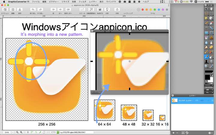

    issue-2
    When you open the "About" window, the icon is destorted.
    Cause
    I assume that when you made b) from a), you simply used a reduction process.
    The orange part is filled with irregular dots and gradients.
    Because of the direct reduction, the image was interpolated and deformed.
    At 256x256, the dots have already been destroyed, causing halos.
    (fig. )
    At 64x64 and below, the original taste is lost.

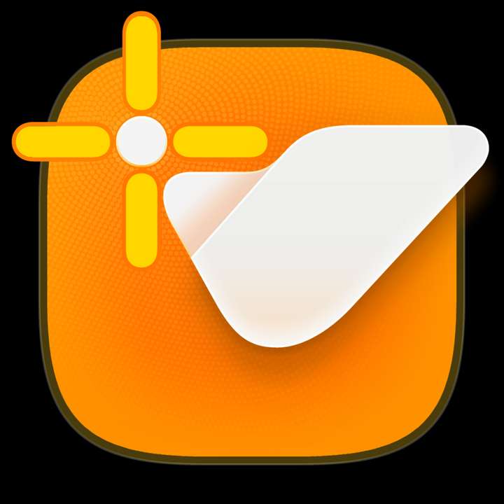

  • @861475_VctSt Are you running the latest version on the Mac? Here in version 1.0.044 the dots of the "spiral" pattern around the white dot are bigger and with more space between them:
    But indeed there is a difference between the icon for Mac (.icns) and the one for Windows (.ico) — on Windows the spiral pattern around the white dot has an overlap, and the orange background is a bit lighter. I guess it was left that way from an older beta. Easily fixable, I think.
    Anyway, should the semi-transparent contour around the rounded square be changed to opaque because it creates unintended blur?
    Doesn't seem blurry on my Retina screen, but…

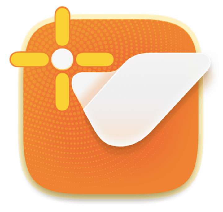

    I also took a screenshot.
    This result depends on the monitor environment, so it's not really comparable.
    (fig.)
    The dot pattern is now larger.
    The outer frame is even blurrier.

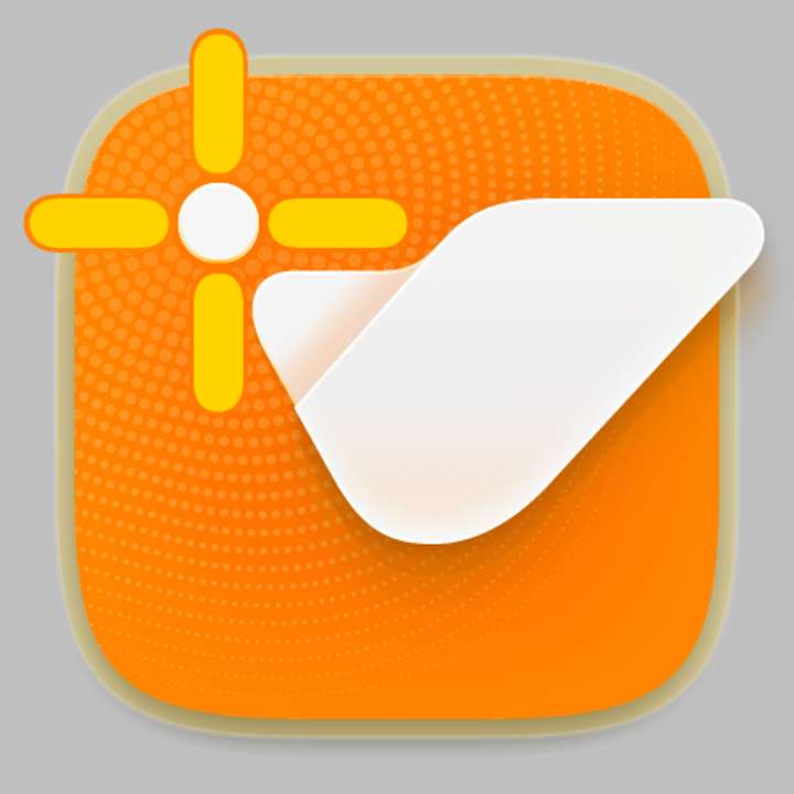

    Since I was curious, I examined the icon data in a different way.
    I extracted the ICNS data from Finder by the following procedure.
    -Select the VS icon from Finder
    -Copy VS from the contextual menu
    -Create a new image from the clipboard in Preview
    -Eight different icon images are created.
    I laid out the background in gray to make it easier to see.
    (fig.1024×1024)
    It seems to look different from the original VS resource.
    The dots are also larger now.
    It looks like b77's icon image.
    It seems that ICNS data is processed in some way in the Finder and clipboard process.
    I thought I should scrutinize the original resource itself.
    In any case, I think the following should be considered for icons of 256x256 or smaller.
    -Dot pattern in the orange area
    -blurred corner R-frames
