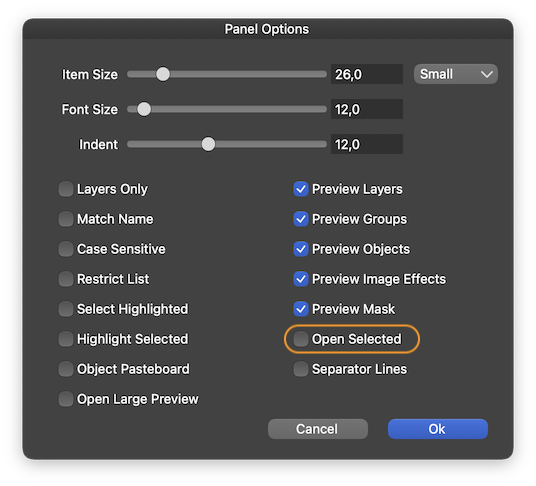

      Is there a way to stop the layers from expanding to show the sub-layers each time they are moved inside the layers panel?
      Is this a handy feature to others? For me it just makes things confusing because I have to keep closing the layers
      For me, I'd rather the layers just stayed as they were when I moved them - if they were already open, let them stay open, if they were previously closed, let them stay closed even after the move
        b77 @Boldline
        @Boldline Click the Layers' options button in the upper right corner, choose 'Panel Options' and in the options window you can uncheck 'Open Selected':
          Boldline @b77
          @b77 awesome! thank you
