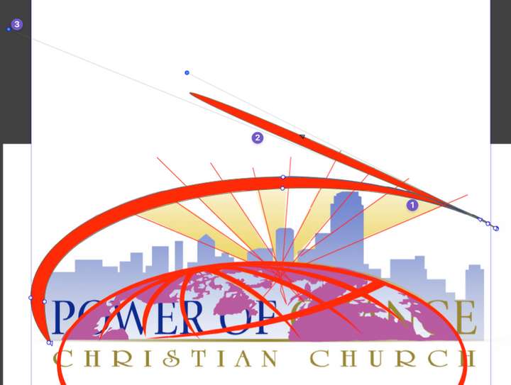

      Is there a better way to delete interior nodes to "fill in a gap"?

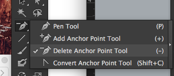

      I know we discussed in another thread a while back about the way Illustrator handled it - if you deleted a node directly in Illustrator, it created a gap in the path. if you deleted with the "Delete anchor point tool" (minus key), it would remove the node, but keep the path intact. 0_1632616347424_91473cbc-40a7-468b-ac7b-75494d4afc8a-image.png
      I included a video from Illustrator using a random shape with cusp nodes and smooth nodes, etc... I went through and deleted nodes from it using the "Delete Anchor Point Tool"
      The resulting handles were not super long and crazy - it allowed for quick deletion. Doing this in VS, we get long node handles and loopy results... Is there a way to tame in those long handles and overextended fills?

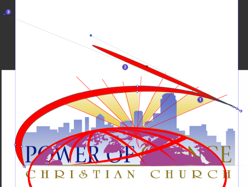

      Just as another example - when I delete extra interior nodes of the same shape as the first video - this is how extreme some of the nodes and fill gets: I deleted a node near #1, that created a huge extra blob of a fill (#2) and extended nodes really far out (#3)0_1632617108623_c523415f-3fe0-45c9-b1de-bdceeb129c54-image.png
      b77B VectorStylerV 3 Replies Last reply Reply Quote 0

        @Boldline As an alternative, you could break the shape apart (right-click > Break Apart, or Ctrl-K) and delete the smaller part.
          b77 @Boldline
          @Boldline I just figured out that you can use 'Normalize Winding' for this (Object menu > Shape), which gets rid of the inner path faster than 'Break Apart'. 🙂
