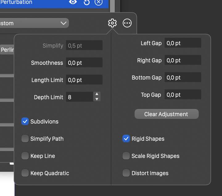

@michaelokraj No need for a trick, this one actually exists for Shape Effects, for example with Distortion -> Perturbation we can get (steps after image):
Add a shape effect in the Shape Effects panel (here is an example with Distortion -> Hole: https://recordit.co/OAL900tGvE).
Open the shape effect (arrow before the name).
In the effect parameters popup, click on the settings icon (wheel).
This opens another popup. Check Rigid Shapes.
This options is available for most effects (except the ones in Outline). So you can control the moving around, for example with a mesh also. BTW: the objects must be grouped before the effect is applied.

@michaelokraj One more note: There are a number of destructive shape effect brush tools in the toolbox. For example there is vector Liquify tool.
These also have the Rigid Shapes option. Double click the tool icon, and in the Brush options vie click Options. The second checkbox on the right side of the popup is the Rigid Shapes option.This can be quite effective for example when used with the Liquify tool, to manually nudge around shapes.
