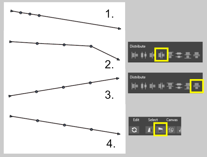

          For me it works. (VS, Win 10)
          Only at step 3 there was an unexpected flip of the line
          so I have to reverse it with a vertical flip.
            Subpath @Gremriel
            @Gremriel
            Even though the tooltip only says objects.
            In VS, you could use all the tools in the alignment
            panel for nodes as well.
            I know this possibility from CorelDraw and was delighted to
            find that in my attempts works also in VS. And I think VS does
            it even better than CorelDraw.

                        If the Line flip, you could still reflip it.
                        See in my steps i mentioned above.

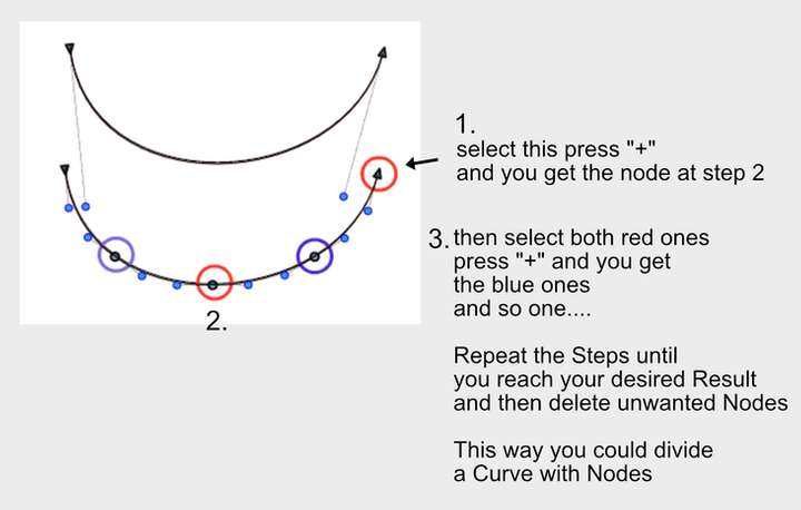

                                    Got a kind of workaround for that.
                                    Its a function i know from CorelDraw and VS have this also.
                                    Take a look at the Picture here.
                                    The Nodes you set this way, will always be in the middle.
