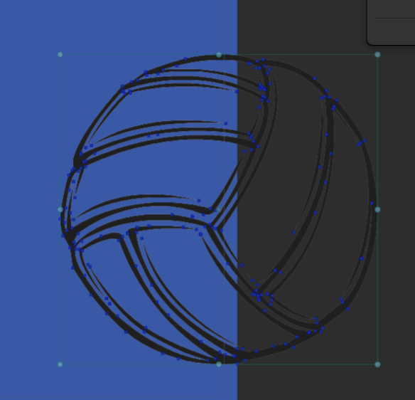

        @b77 Ungrouping did the trick! union was not available or accessible even, but that is because the volleyball was already one unified shape - no overlapping parts. But I understand the purpose for union in cases with multiple overlapping individual shapes.
        "Break Apart" worked! I'd never considered "break apart" would result in solid fills where there was once no fill at all. That's fascinating! Thank you for sharing that. I'll be adding this to my workflow for sure.
        It's great that it creates a fill where this was negative space - and I love the way "break apart" creates a solid backing fill behind everything.
        Also interesting is that once I've created it using the break part method, if I select all including the backing solid fill and hit "merge" at that time, I get the individual parts I was initially wanting (individual shapes with no backing fill)
        The only downside to using this method is literally everything becomes the same exact fill color and you have to go in and edit the colors piece by piece. Not a big deal on a simple design, but more cumbersome on others.
        All that said, I still would like to see "separate path" be the tool that I was describing initially, as I believe it was added for. Having both options would be ideal in my mind as I would use them differently

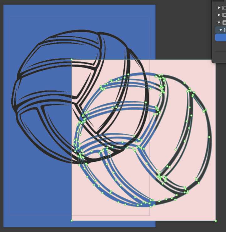

          I tried again with the volleyball and "ungrouped all" first - made sure it was all one shape (union was still not applicable here since it was always one shape). I tried "Separate Path" here at this point to see if it acted like "break apart", but it did nothing. I added the rectangle shape in the background and selected both and merged, then clicked on "separate path" and had no visible changes - the merged result was not broken up into separate parts. I don't know if there's a bug with "separate path" or I'm not using it correctly

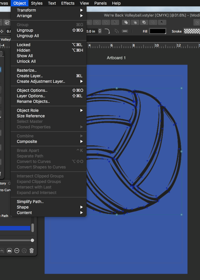

            @Boldline OK, so 'Separate Path' explodes any object made of separate paths into separate objects.
            That's why it doesn't do anything in this case, except maybe it separates the unconnected thin brush strokes.
              Boldline @b77
              @b77 Is that any different than just "ungroup all"?
                b77 @Boldline
                @Boldline Groups can be:
                • individual objects grouped together;
                • multiple groups that are grouped together;
                • a mix of individual objects and groups grouped together.
                'Ungroup' ungroups separate objects or groups that were grouped.
                'Ungroup All' does successive ungrouping until any grouped groups are ungrouped.
                'Separate Path' explodes one composite shape into separate objects.

                      So "separate path" would be the solution if I had a compound shape/ if I used the combine boolean operation prior to make a compound shape
                        b77 @Boldline
                        @Boldline Yes, any shape made with the Composite operations in the Object menu can be "exploded" into the initial shapes with 'Separate Path'.
                        Not so with shapes made with the destructive Combine operations (Object > Combine).

                                          The "Break apart" is a really awesome tool that I plan to use a lot in my work inside VS. I don't think we have to only choose one way to do this task - with the blessing of @vectoradmin both options could be available. Merging a fill shape behind a vector with open spaces already "cuts" into the fill shape - now we just need a way to ungroup that merged result (see pic below)
