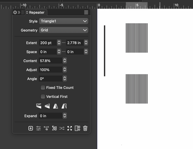

I want to create a repeater using a thin line fill rectangle to look like this when applied to a gradient:
What is the best way to create this because when I do it the usual way, nothing happens.
I am guessing it has to do with the length of the symbol not being the same or smaller than the gradient box. I tried again with a smaller thing rectangle "line" and it "worked" as in, it showed a diverging path of two shrinking rectangles... I am sure I'm thinking of this in the wrong way - it's also in grid mode but I don't know what else I would use...
