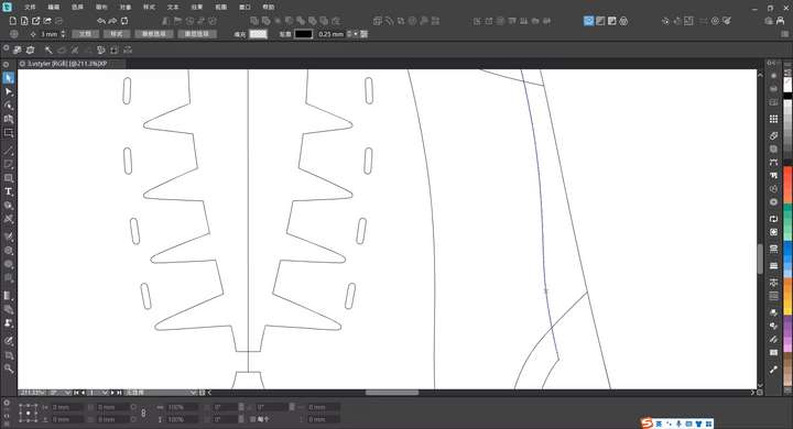

            @VectorStyler 9. The corner rounding function of the Contour Path effect is invalid.0_1764341364253_mmexport1764340491651.jpg
              VectorStyler @monsterfox
              @monsterfox said in Bug List for Version 1.3:
              8.The Convert Shape function is not working properly yet; it only supports parametric shapes, and regular paths or paths converted to curves will all fail.
              In general closed shapes cannot be used as corner shape. Send me a shape that fails.
                  @monsterfox
                  1. The corner rounding function of the Contour Path effect is invalid
                  This one is not clear. From the image I can see the effect applied on a straight line, that has no corners so corner selection has no effect on this.
                  If you need to set the endings (rounded, etc), that can be accessed by expanding the effect options with the rightmost knob after the effect name

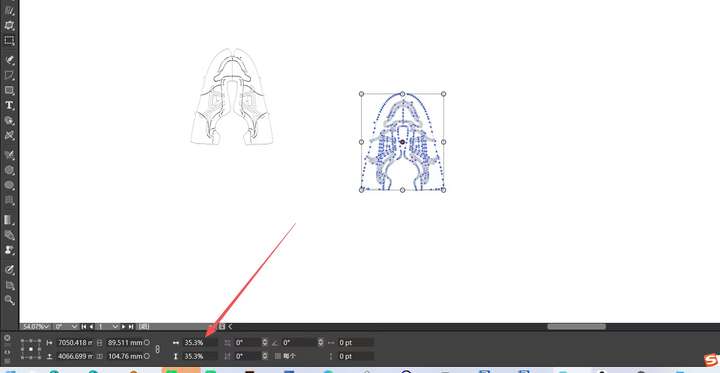

                                @VectorStyler Error 1 Addendum: DXF files can now be imported, but there are still a few issues: 1. The imported DXF file does not have the correct size. 2. Dragging the provided file into the canvas converts it into an image. 3. The DXF file exported by VS also has an incorrect size, which is larger than the original file. These issues need to be fixed.

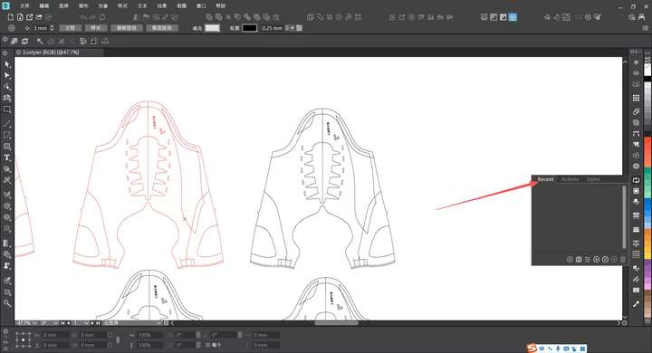

                                  @VectorStyler Error 5 Addendum: Several incomplete translations have also been found.
                                  1_1765467480521_mmexport1765467415023.png 0_1765467480498_mmexport1765467402750.jpg

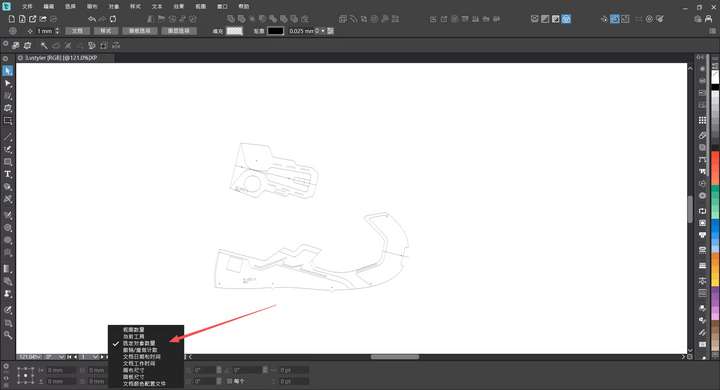

                                    @VectorStyler !
                                    12. The display of the selected object count is incorrect. When multiple objects are selected, it shows their respective layer names instead of the selected quantity statistics.
                                    1_1765467598767_mmexport1765467529879.jpg 0_1765467598750_mmexport1765467523415.jpg

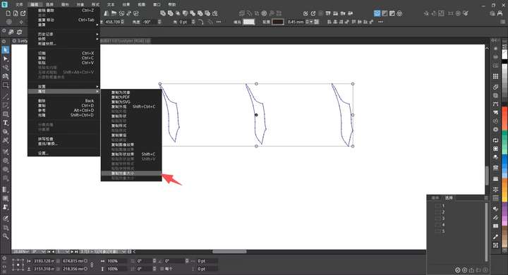

                                          monsterfox @VectorStyler
                                          @VectorStyler 1_1765469312130_mmexport1765469232574.png 0_1765469312112_mmexport1765469235264.jpg
                                          13. The options for copying and pasting object dimensions cannot be found in the shortcut menu, and they need to be added.
                                            If a document was saved while using the English UI, then some text will be in English. These names (customizable by the user) are stored in the document, not by the current language.
