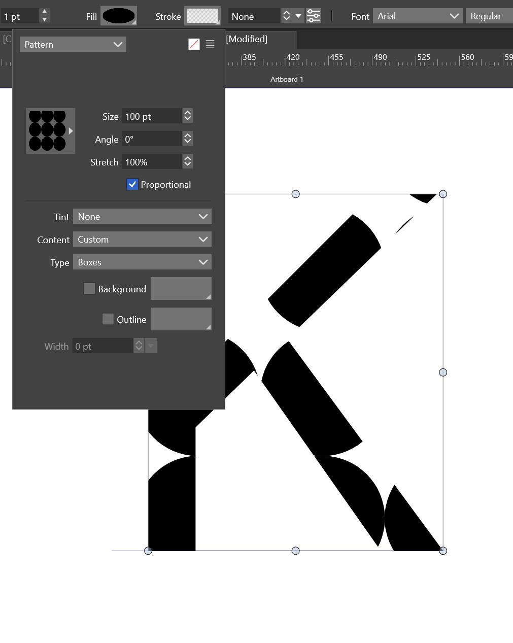

      My first thought was that Pattern Brushes might be the solution, and for a moment it seemed promising. They came surprisingly close to the desired result.
      However, it was still limited.

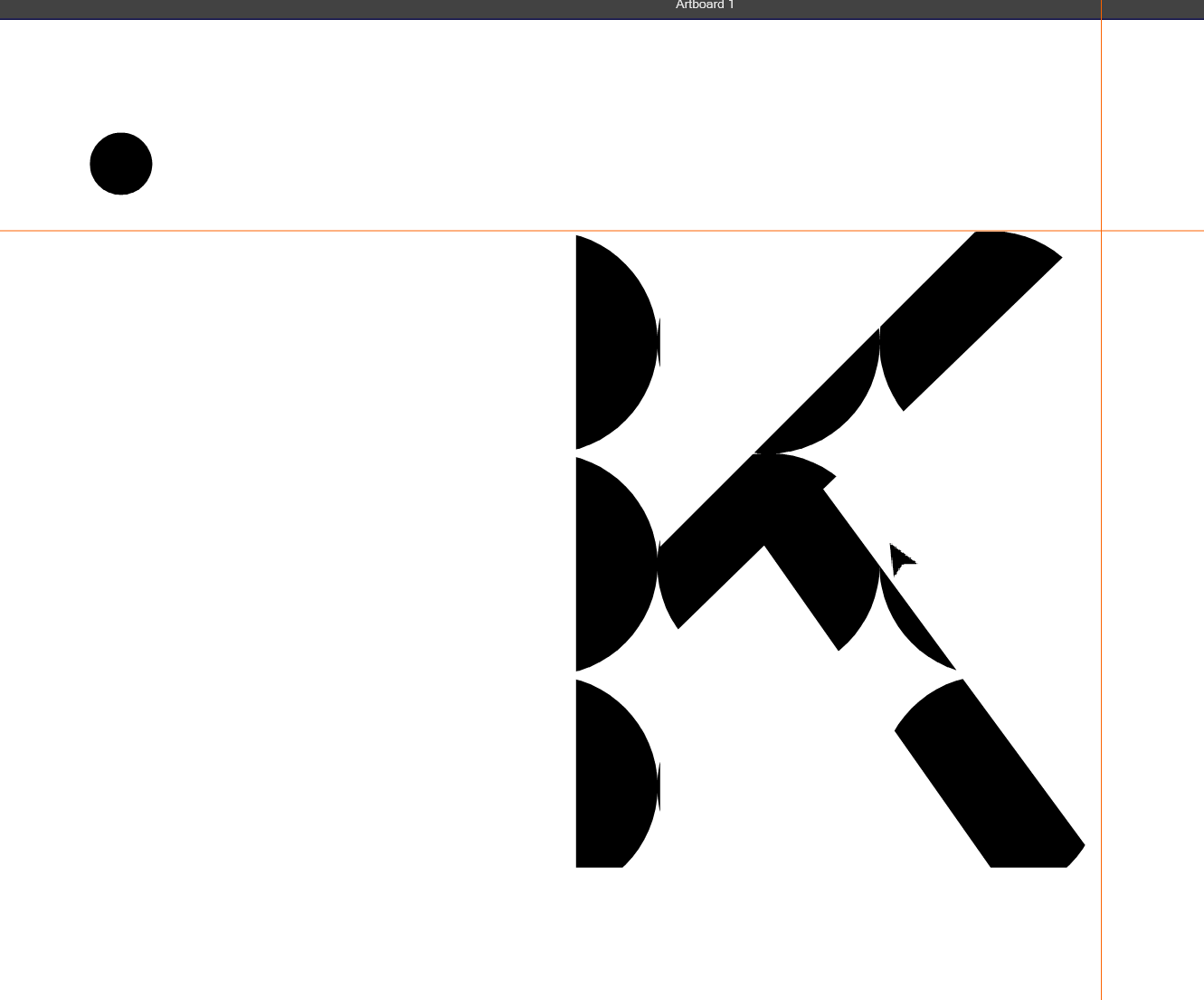

      The result was only visually confined to the interior of the shape. The circles were not actually being recalculated based on the geometry of the letter.
      Instead, the pattern was simply clipped by the boundaries of the object. Any circles that crossed the edge were cut off, rather than being removed or repositioned.

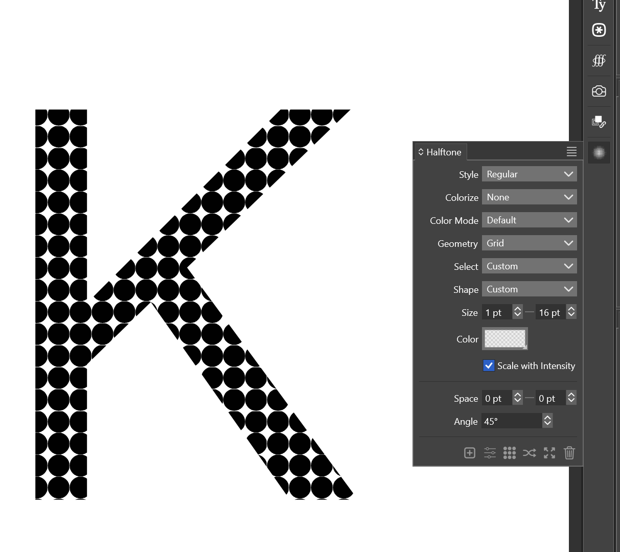

      Then I thought about using a halftone-based approach.
      At first, it seemed like a promising direction, since halftones are specifically designed to generate regular patterns of dots within a shape.
      Unfortunately, I ran into the same limitation.

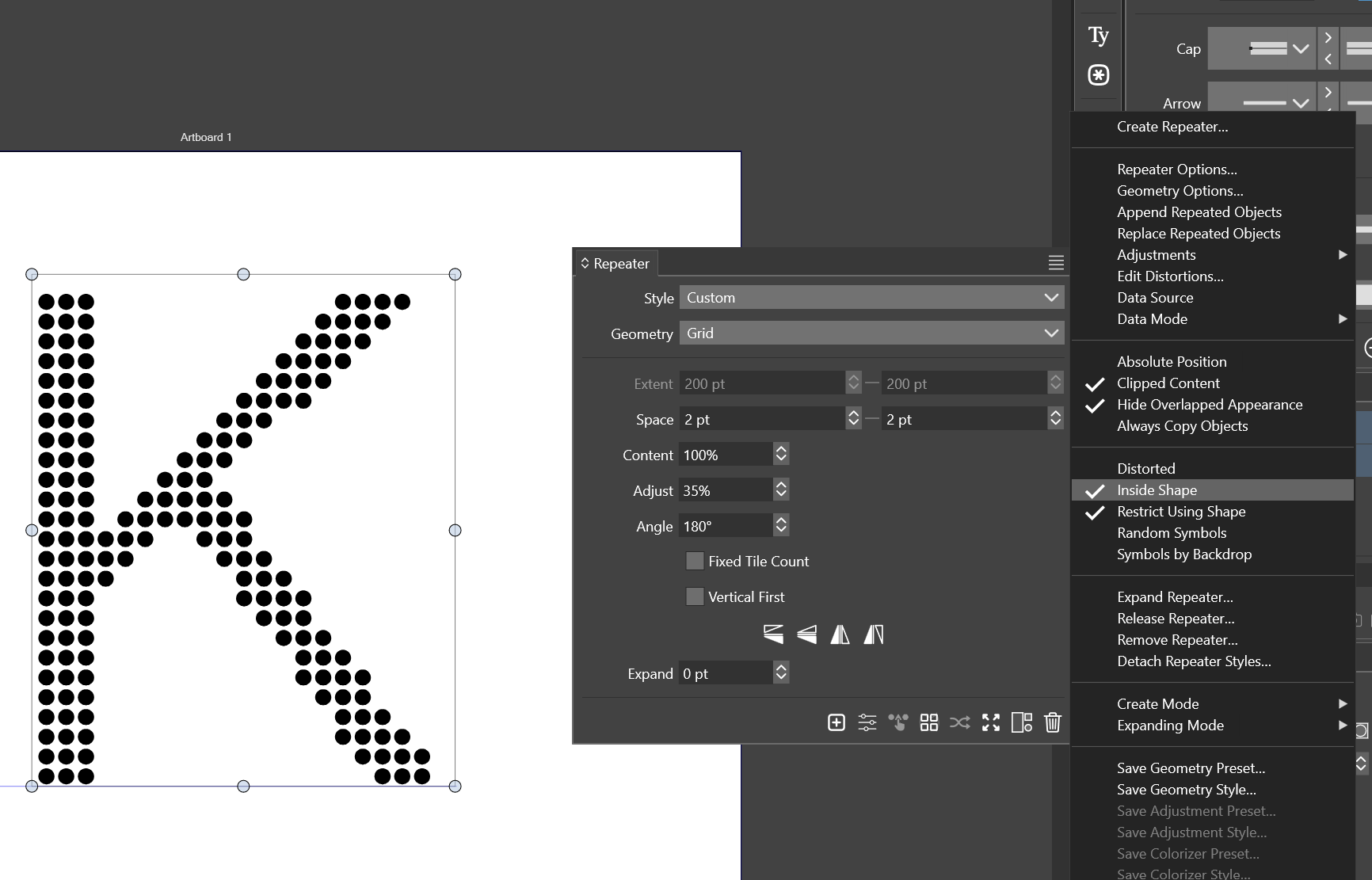

      This finally led me to the solution I had been looking for: using a Repeater with the "Inside Shape" option enabled.
      Unlike the previous approaches, this method distributes the instances according to the boundaries of the shape itself. The spacing can be adjusted independently on the X and Y axes, making it possible to create a regular grid of objects while keeping the workflow fully editable.
      For my use case, this was the closest solution to the original goal: generating a reusable circle-based or symbol-based effect inside arbitrary typography without relying on clipping masks, pattern brushes, or manual Pathfinder cleanup.
