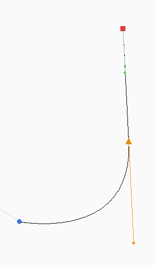

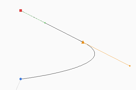

        @VectorStyler: No. Tangent or connector node is not the same as symmetric:
        Sharp - Basically has no handles - Straight line segment: But in our algorithm, we have made Sharp nodes to have handles because this means there is no need to convert them. You just pull the handle.
        Cusp - A subtype of Sharp node, where both or one of the handle exits and can be moved in any direction independent of each other.
        Smooth - Both handles collinear but can be sized independently.
        Symmetric - Both handles collinear and locked to same size.
        Connector/Tangent Node - Node that sit at the transition between straight line and curved segments to help form mathematically precise transitions so there are never any kinks. This is achieved by having the handle follow the direction of the straight line exactly. A tangent node is only really useful if it has one handle, but it is possible for it to have two handles. In every case, the handles always point back at the chord of the adjacent nodes. When the adjacent node moves, the corresponding facing handle moves with it.
        The orange triangle is a tangent node and the handle lies on the chord to the square node forming a mathematically precise transition. When you move the red node, the tangent is repositioned. Like so.
        This guarantees that I don't need to worry about my transition. Our documentation exhaustively explains this.
