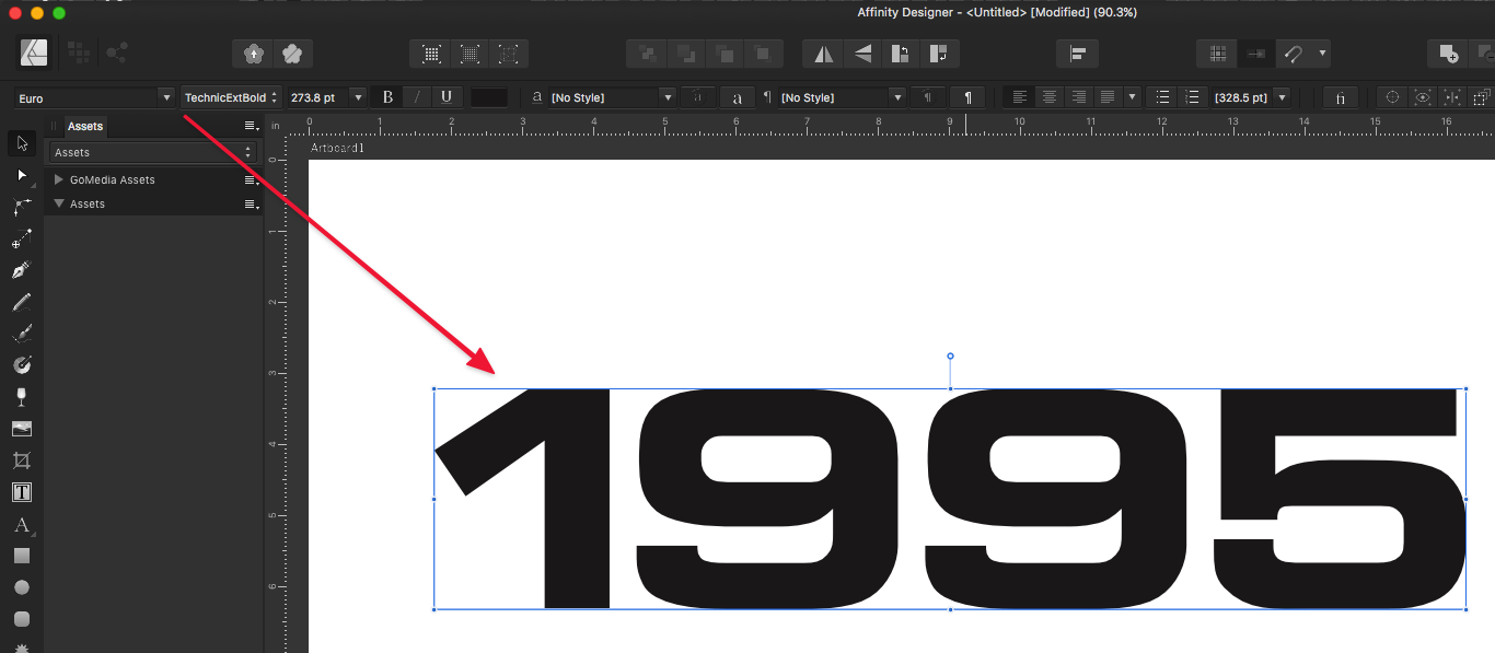

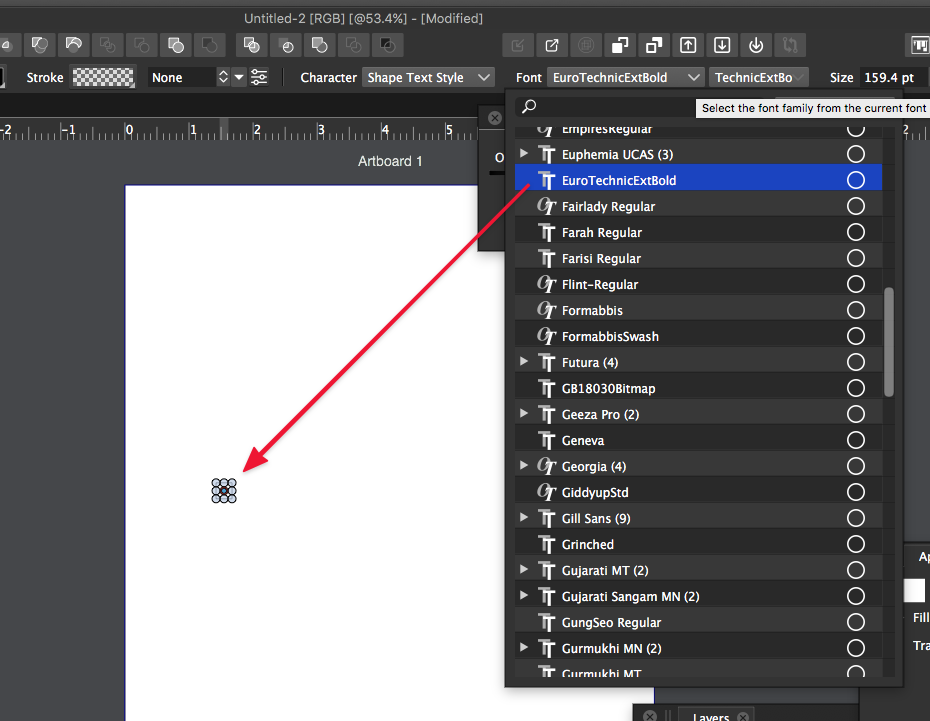

      This topic has been discussed before in the past. I was dealing with it again today. I wanted to use a font called "Euro TechnicExtBold" in a design on VS. The font does not show up as available . But if I switch over to Affinity Designer or to Illustrator, it works just fine there. I know very little on the technical side about fonts. I do remember there are some issues with Type1 fonts. I confirmed this is a T1 font unfortunately. Does this mean any T1 fonts will always be unavailable in VS? In the plan to use VS full time, is there a planned workaround? Is there a simple answer as to why they would work in Affinity but not in VS?
