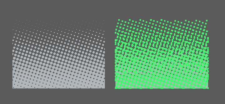

          @b77 Good point. I have vectored halftones like this one in the attached image below, that I was thinking I could set up as a repeating pattern symbol or attribute in VS

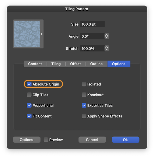

            @Boldline Create a pattern using the halftone, and set the tile size to be large (at least the height of the text).
              b77 @VectorStyler
              @Boldline You'll need to uncheck 'Absolute Origin' in the pattern's additional settings, so the pattern moves with the text or object.

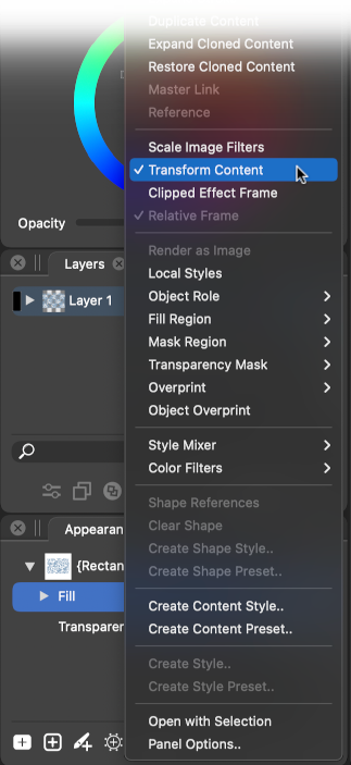

              @vectoradmin Is there a setting/checkbox that makes a pattern fill scale with the object? I assume BL wants to create a style that scales the pattern inside along with the text.
                b77 @b77
                @Boldline To scale the pattern along with the object, go into the Fill's settings and enable 'Transform Content':
