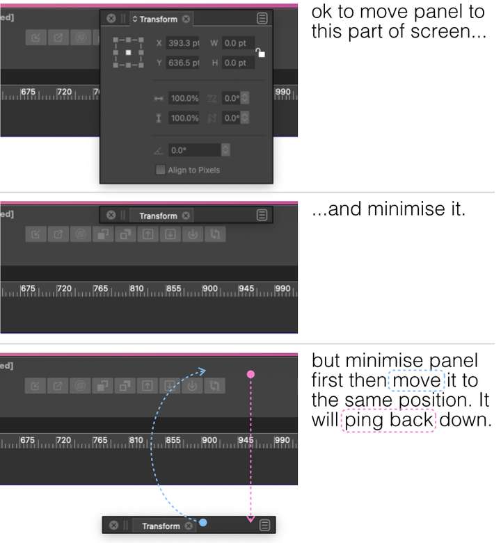

Whilst talking about minimising panels...Very minor thing, but I thought I would mention it anyway!
If you have an undocked panel it can be positioned anywhere on the screen (except when near a docking zone) and can be minimised in the same position.
But if you try to move a panel already minimised, for example up to the part of the screen where the file name is displayed, when you release it, it jumps back further down the screen.
@Jono This looks like a bug.
@Jono This issue is fixed in 1.1.002 (beta)
