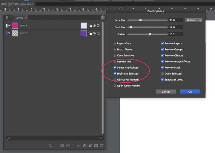

            @Boldline Are the "Select Highlighted" and "Highlight Selected" options enabled.
            These do cause a bug in layer selection.
              @vectoradmin yes they are. do I need to turn those features off to have it paste correctly each time?
                @Boldline Try turning them off. If there are no other cause for this issue, then it should work.
                The fix for the problems caused by these two options will be in the next build.
