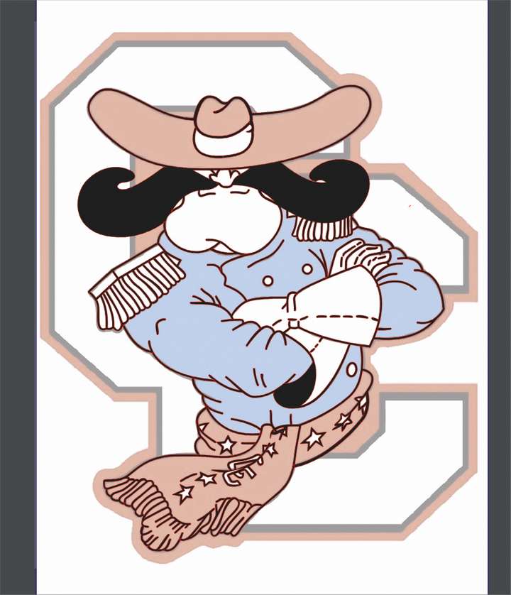

        Yes I was able to do work in VS and save it properly in VS AFTER upgrading to Monterey. In fact, the file I sent you yesterday by email (screenshot below) was done completely in Monterey/VS and saved just fine.
        I was able to reopen that file today without an issue. I tried to save it today and VS closed immediately
