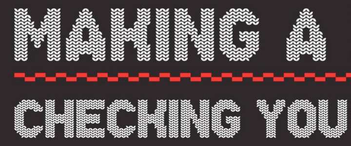

      This may already exist in VS and I don't realize it. I would like to be able to create a pattern (like the Christmas sweater thread in this example) and then apply it to any shape - whether it be a letter shape or a star shape or a silhouette of a pumpkin, etc.
      I know I can clip a pattern inside a shape, but that can leave parts of the pattern cut off right where the shape ends.
      Can this be done so that parts of the pattern are not cut off where the shape ends? Like what you see in my example below in any letter with an angle?

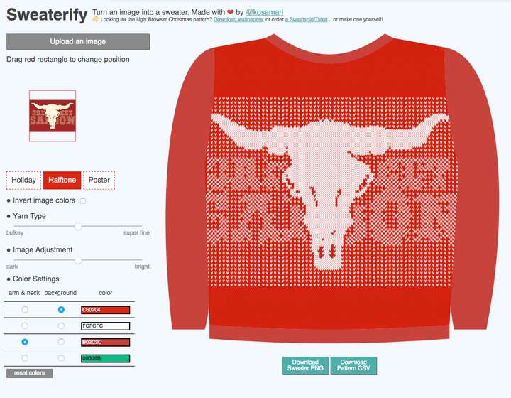

          @vectoradmin I found this website online that was really interesting.
          It basically converts your raster image into an ugly sweater. Of course, the results here are raster and the feature I am looking for in VS would not be only used for replicating an ugly Christmas sweater, but the concept is neat - and that is what I'm hoping can be added in VS

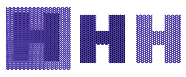

              Hi, maybe a simple solution.
              But why don't create an array of your pattern, put it over
              the letters of the font and delete all the objects that overlap
              by hand ? So nothing is cut off like with the clipping mask.
              Here is an attempt of mine.

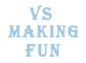

                    @Boldline It is doable with Repeaters. Still a bit slow, but it can be expanded once all attributes are set:
                    0_1639482524952_pattern1.vstyler
                      b77 @VectorStyler
                      @vectoradmin Interesting! But I would disable font preview on the canvas with this — it froze the app here and I had to force-quit.

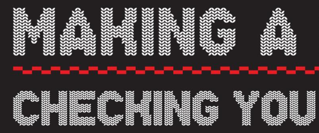

                                  Could not resist 🙂
                                  Have use the File from vectoradmin.
                                  To make this picture, i had to combine
                                  three VS-Files for the Text.
                                  But that the text remains editable, even
                                  with this pattern on it, leaves me
                                  speechless!
                                  The Picture was build from
                                  three Bitmap Files.
