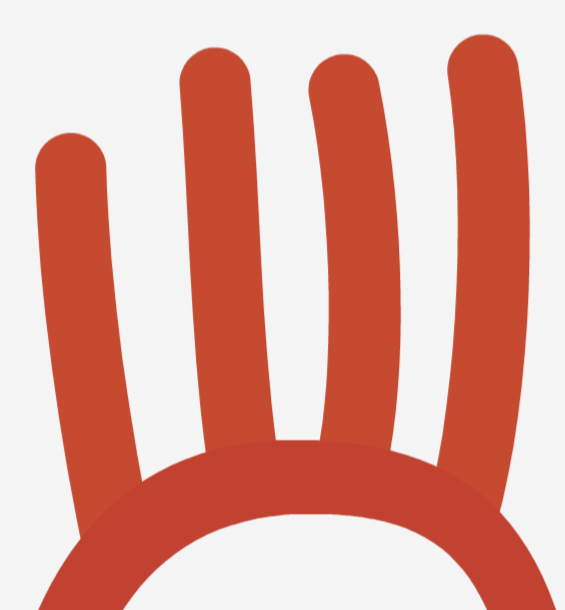

      • When I export these vertical brown lines in the original drawing, their stroke color is exported as the same orange as the circle
      • When I export these vertical brown lines copy pasted as a new document, their stroke color is exported as black
      Ungrouping the vertical lines triggers a real Poltergeist experience.
      All I did was to draw these vertical lines with the pen tool and group them, so I don't get it.
      No other objects are behaving like this in the drawing with more and more objects.
      Example

        @Ingolf Only when you export it as SVG is this a problem, right?
        Ungrouping not working correctly seems to be related to the objects not being on a layer.
        If you select both objects and choose Collect in New Layer from the Layers panel menu, ungrouping of the hair strokes should work: https://recordit.co/7DBKg1QEjj
          VectorStyler @Ingolf
          @Ingolf Exporting seems to be working fine, and I did not get any noticeable change after ungrouping the lines.

            This is what I experience with the attached file (macOS 12 M1)
            Attached
            This is what I get doing the same with the original document:
            🍏 macOS Sequoia Apple Silicon
              @Ingolf Send me the resulting orange.svg file, some thing is wrong with those colors.
              this is what I get: 0_1639381850231_orange.svg

                Clue: After expand stroke the problem disappears.
                • IngolfI Offline
                  Ingolf
                  Fixed in first beta
