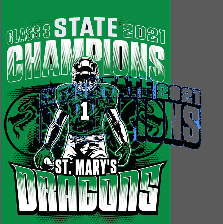

  • This is example in Illustrator of what I do with my vector art for apparel design before I send it to my clients for their use.
    I typically have my art in groups of things stacked over top one another and often on different layers for each grouping. I make a copy of the art file so not to lose the layers of art . On the new copy of the art, I consolidate everything onto one layer and then expand it in case there's a hidden stroke in there and then I merge the entire design using the pathfinder boolean operation. This flattens the design entirely and what you see is what you get... there is nothing under the parts formerly in the front of the design overlapping the back parts. In Illustrator, even if parts are on different layers, if I select them all and click on merge, they all go to one layer and flatten.
    In these screen shots - you can see the individual groups overlapping each other and then after the merge, the parts are no longer using their original styling
    In this first picture you can see the final design:
    Here you can see the design is composed of different groupings of vector shapes and such all overlapping one another. I've pulled them apart to show this

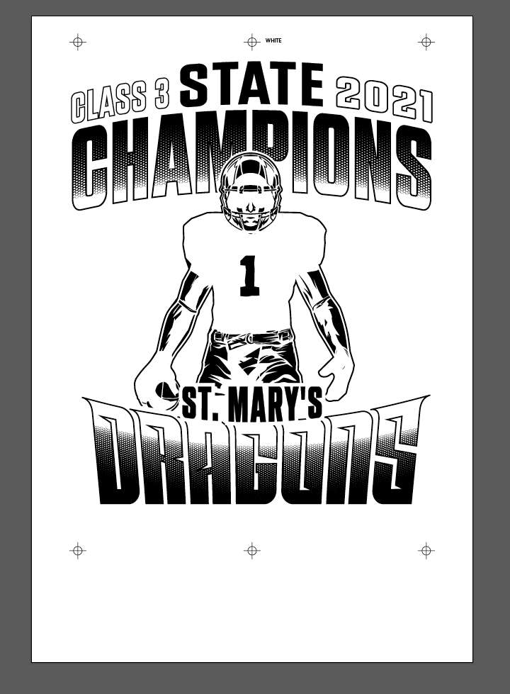

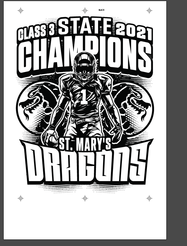

    After using the Illustrator pathfinder "expand" option - you can see that the vectors have lost their individual styling and groupings. What you see is what you get... nothing is stacked anymore.

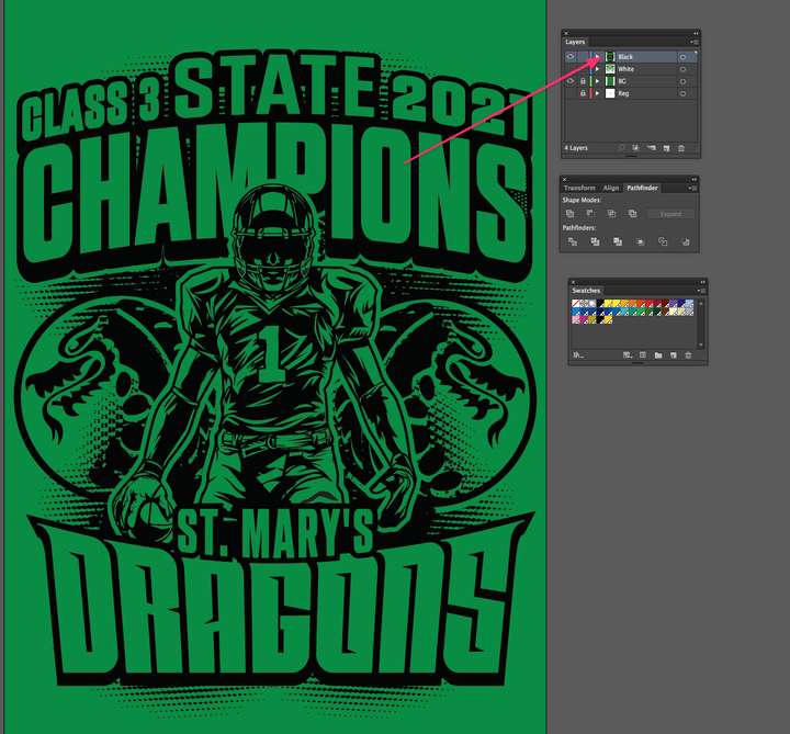

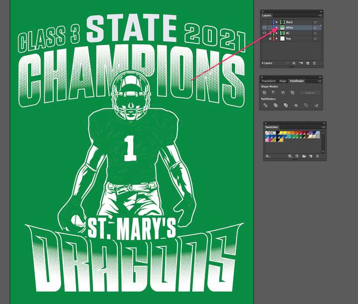

    This allows me to separate the design by color very easily - below are two images showing how I copied the layer with the art and removed one color from one and the other color from the other so one is only showing the black in the design and the other is only showing the white
    In the end I set up the designs with registration marks and change each color to a deep black (0,0,0,100%) so it will print out and be opaque so when the client burns the screen, the light does not pass through the opaque areas.

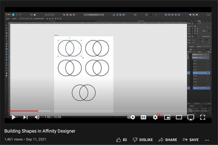

  • The other day I was watching random YouTube videos about vector design as I worked. This video came up and as I was listening and occasionally glancing up at the video on the other screen, it hit me that Affinity and in many ways VS seem to view the boolean operations differently than I usually think of them.
    0_1640910811691_0e9c13c7-900d-4ac1-a032-45c0787d0eb1-BLD 2021-12-30 at 19.30.19.png
    In the simple video, the designer was showing how the various boolean operations worked in Designer on a basic level... while I knew this information, it seemed to me most people view boolean operations only as a way to build shapes through adding and subtracting. I do use some of the boolean tools for constructing more complex vectors during the design process - but I mostly use them while in Illustrator, to prepare art for exporting. So I'm sure some view the boolean operations as strictly a vector building tool and not as a way to simplify and remove styling no longer needed.

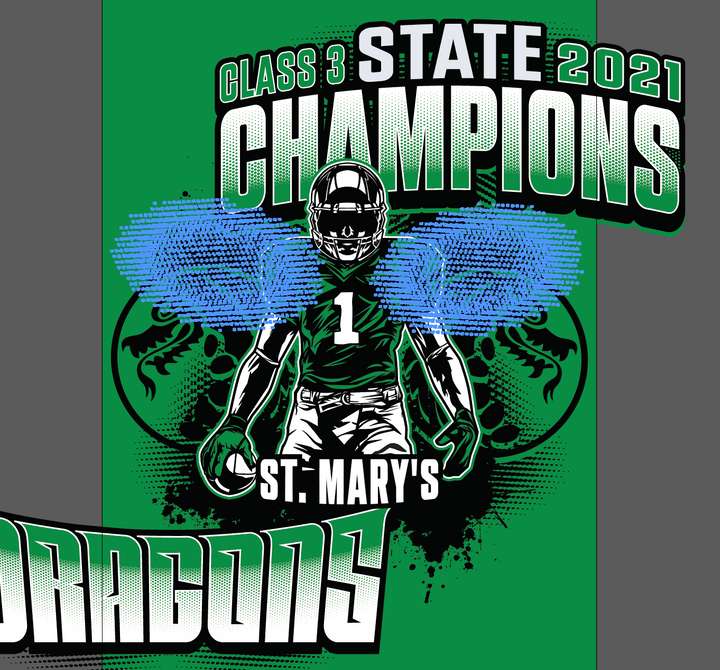

    Here is my example using the same owl vector in VS and attempting to accomplish the same goal.
    In some ways I love the options of the break apart method - but there are a lot of times I would like to be able to just use the merge like I did in both, and the hit a button - such as ungroup in Illustrator and maybe "separate path" in VS and not have all the break part options - and instead just have the immediate ability to get rid of the outside yellow portion and keep the interior yellow.

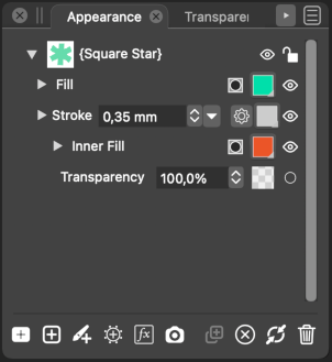

  • @vectoradmin Hey, we have names for this — 'inner fill' and also 'inner stroke' sounds good, and yes, you should be able to assign solid color, gradient and patterns. 👍
    The 'Add Fill' and 'Add Stroke' buttons at the bottom of the Appearance panel could be Option-clicked to add an Inner Fill or Inner Stroke instead.
    Assigning a gradient or pattern to the negative space could work with Option-drag? (Shift is used for gradient angle constraint).
    Not sure about how an Inner Fill or Inner Stroke attribute should be displayed in the Appearance panel. Slightly offset to the right like this maybe? Or just having different names will suffice?

    So going back to my recent example with the owl mascot and the yellow rectangle being merged... Wouldn't that result in a composite shape?
    After merging, I pulled the yellow rectangle over and the mascot had been "punched out" but the entire rectangle acted like one composite shapemi would assume separate path would be the way to break it apart?
