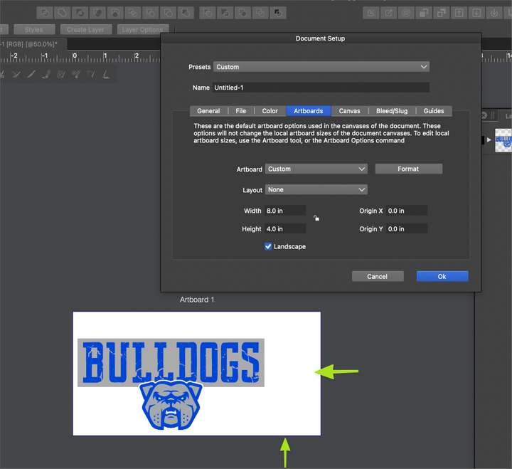

      Could we add an interactive edit to sizing the artboard? Like a crop tool one could use to reduce or enlarge the horizontal width or vertical height of the board? Sometimes I'm resizing art and it's just easier to be able to set it visually. This is an option in Illustrator I got pretty used to
      0_1641345969301_5ad93452-16ca-47ec-b175-bd7c46a59094-BLD 2022-01-04 at 20.21.03.png

            I'm not following where you telling me to look. I'm not seeing an way to adjust the artboard with a crop tool like method - or did you mean just changing the size where it says width and height?
