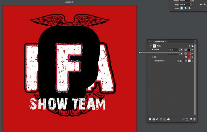

      Using the stroke width slider in the appearance panel, it jumps up way too quickly given the common stroke sizes one would be sliding up to with it. Could this be adjusted?

          In this case, I only imported that back shield eagle part and the rest was all made natively in VS. The issue is that the sliders jump up so quickly when most people adjusting stroke sizes are not anywhere in that range

            Apart from the fact that I also find that some sliders in VS
            need a better range of values and could be more precise.
            I read in a post, a while ago. Was also new to me. That it is
            possible to move the sliders in VS in more precise steps.
            if you use the Cursor Up-Key ( in 0,1 0,2 03 ... steps )
            and Shift and the Cursor Up-Key ( in 1,0 2,0 3,0 ... steps )
            Cursor Down-Key decreases the values.
