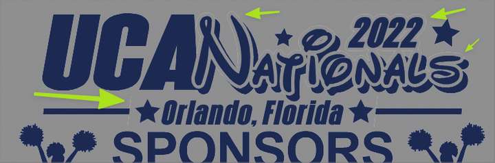

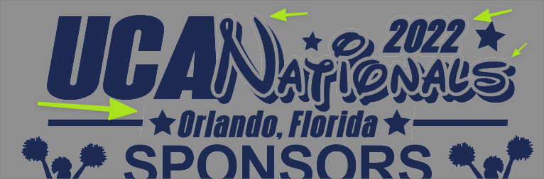

      I like the option to set the artboard color for each project because it represents the apparel color for the particular job. However, doing it this way, I often end up with a hairline white edge showing
      0_1643641571128_6b228e85-d57b-4f0f-b3ac-cbb3914a2301-BLD 2022-01-31 at 10.03.19.png
      @vectoradmin 's response:
      It is just a transparency artifact on the screen. You should draw a big dark rectangle for the background and it will go away.

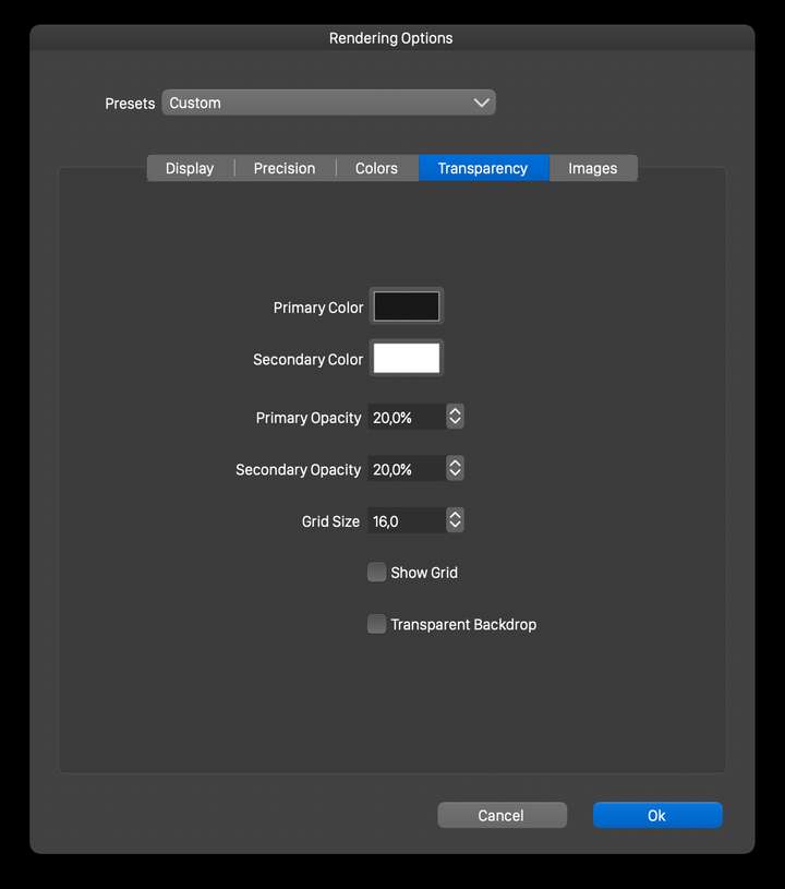

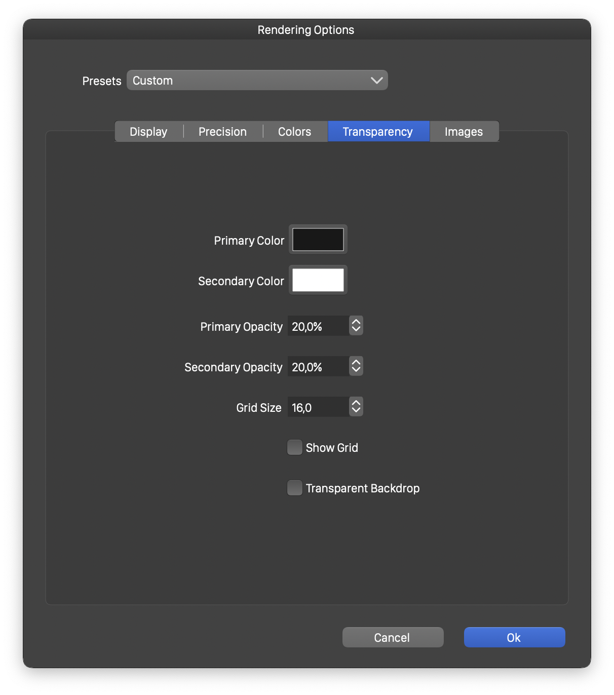

      Another way to get rid of this artifact:
      go to View -> Display -> Display Options -> Transparency and uncheck Transparent Backdrop
      When "Transparent Backdrop" is on the vectors are composited into a transparent image, and that image is then composited with the artboard / canvas background colors (this may result in the thin white artifact).
      When "Transparent Backdrop" is off the vectors are composited directly on the canvas / artboard colors. This may result in "unrealistic" composition, when blending modes are used.
