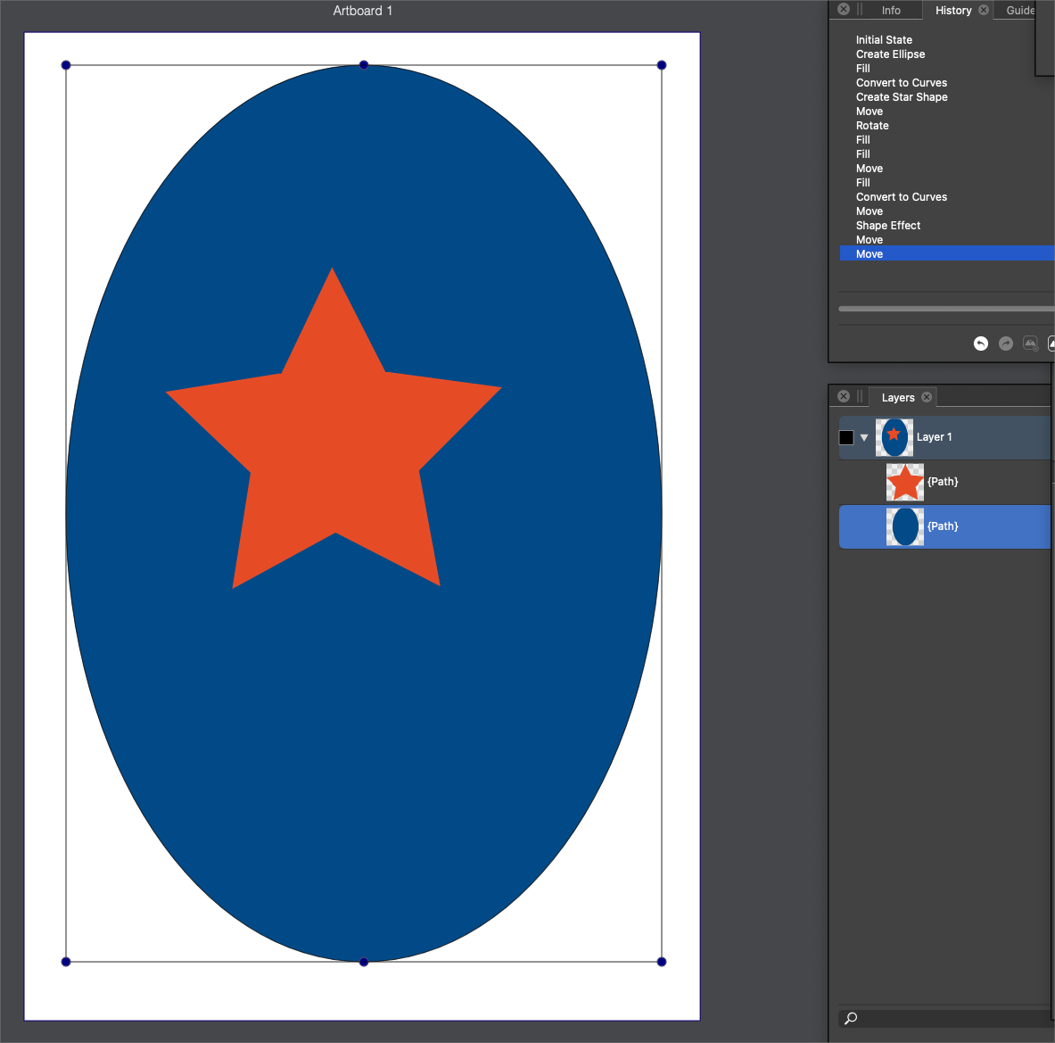

      I've noticed when I have a shape sitting overtop other shapes, it can be very difficult to select the top shape with the selection warp tool. I have to move the shape away from other shapes and then click on it to apply the warp feature.
      Here is an example where it happened in my work.
      I tried it again in a new document using basic shapes for both - a large shape behind and then placed a smaller shape in front of it and had the same result
      0_1643735492303_10ff4dad-54e0-4c5a-8f3b-2ea5a89b3ddf-BLD 2022-02-01 at 12.11.06.png

        Dont know if this really helps.
        But as a temporare Workaround
        how about to use a clone for that.
        Here a video:
        https://recordit.co/cP0nR0X53X
          @Boldline This looks like a bug, will get fixed (but maybe not in the next build).
            @Boldline This problem should be fixed in build 1.1.024
