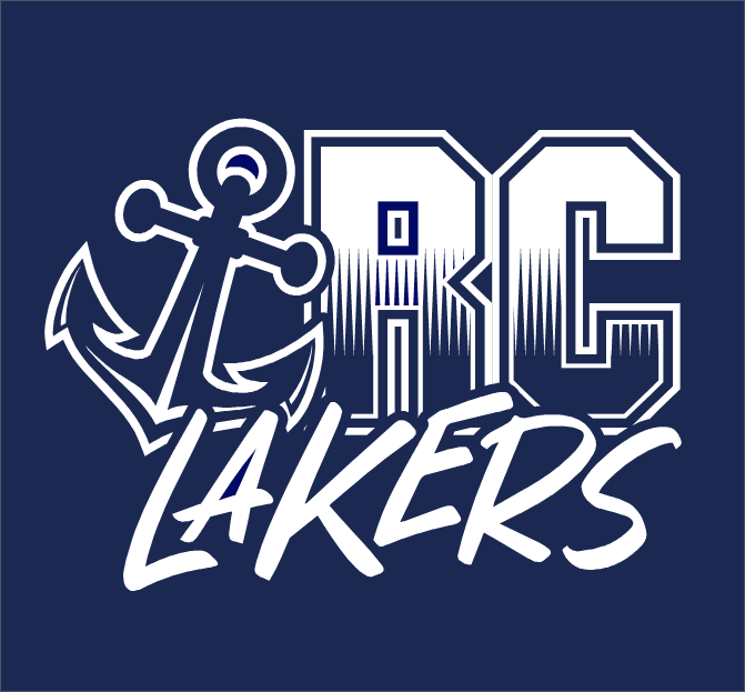

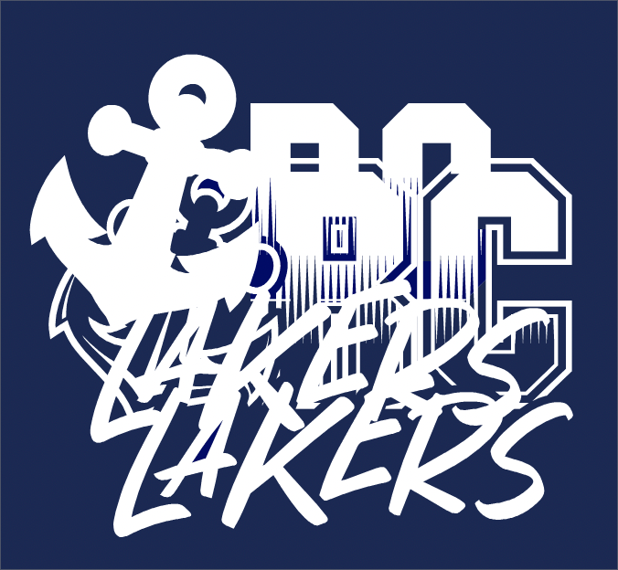

      In this case here, I can't make a selection bounding box around my design, I can only click on it to select it - then when I cut it and paste it back, it spreads things out as shown below in the pics and in this video. The first half of the video is me attempting repeatedly and unsuccessfully to get a bounding box to work before resorting to just clicking on the group to select it
      I assume I am not using the space bar modifier correctly?
      When I went back to my file after writing this post, I can select with a bounding box correctly again and paste/cut/paste results in a normal expected result again.... so I'm trying to figure out what I am doing to change the settings
      Original copied design:

      After Pasting:

        Ok I figured out part of my own problem. I had the same design positioned lower on the artboard in a different layer that I had turned off the view on - but I had not also locked it. So when I went to grab just the top one in the top layer, it also selected the one in the lower unlocked but hidden layer.
