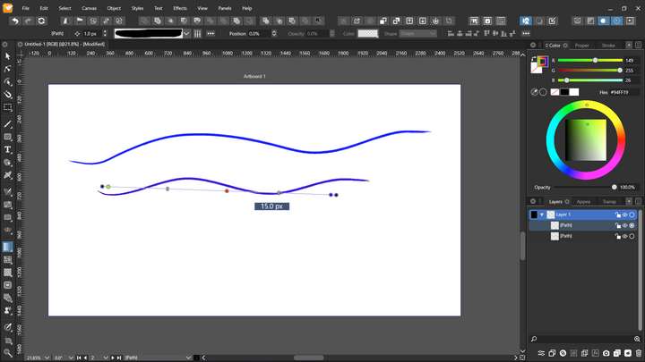

    • J Offline
      Jayanta Das
      I can't apply gradient to a brush stroke. There is no issue with the pen tool, gradient can be apply.
      Mac Mini M4 Pro | 24Gb
      WIndows 11 | Intel i5 11Gen
      Wacom Intuos Pro
        VectorStyler @Jayanta Das
        @Jayanta-Das Gradients (or pattern, or noise) cannot be used on vector brushes. Only solid colors are supported.
        Vector brushes contain vector objects that are stretched along the shape.
        These objects inside the brush may contain gradients, but the overall vector brush can be styled with solid colors only.
        I add this to the backlog as a feature request.

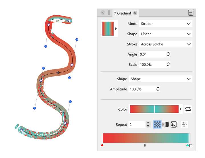

            • Victor VectorV Offline
              Victor Vector
              @vectoradmin , @Jayanta-Das ,
              I think this is a bug and somewhat related. But it helped me troubleshoot the a problem with gradients on strokes, for both "Across Stroke" and "Along Stroke".
              I have the *.vstyler source file generated on a Windows 11 machine, but I was unable to upload it here due to my lack of privileges, so I posted an image illustrating the issue.
              I got this garbled gradient. I was able to make it behave by switching from the "no brush" brush style to any other brush style, then back again. So thanks to this forum post for the hint on how to temporarily fix it.
              VectorStylerV 2 Replies Last reply Reply Quote 2
                VectorStyler @Victor Vector
                @Victor-Vector Send me the .vstyler file by email. This looks like a bug.
                  Victor Vector @VectorStyler
                  @vectoradmin Okay I sent it to contact@vectorstyler.com
                  Thanks!
                    @Victor-Vector Temporary workaround for the gradient on stroke error: remove the stroke cap, by selecting Flat for both ends.
                      @vectoradmin oh lovely! Thanks. It even works with just one end set to flat, if that helps with troubleshooting...
