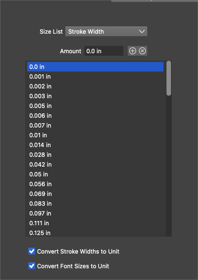

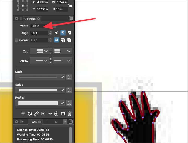

      I noticed when I am trying to adjust the stroke panel size - it will not go below 0.01 - even though I have added custom sizes below that amount in the preferences panel. The same is true with the bracket keys - it jumps downward from 0.014 to 0.01 to 0.00
      0_1646684047442_3aeb4787-2b2c-4acf-aa48-bb35d8751cb9-BLD 2022-03-07 at 15.06.48.png
      0_1646684078321_2f763161-ad49-4ff3-9474-1befb24d1b4a-BLD 2022-03-07 at 15.14.22.png
        @Boldline There is a Preferences -> Number Editors -> Limit Precision option: should be enabled by default but it is not (regression), if disabled, the precision should be better.
