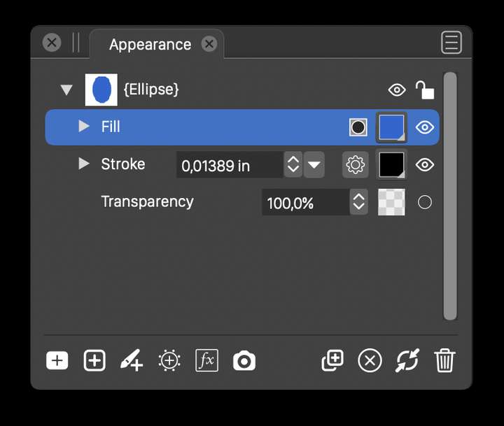

    @Nils In the Appearance panel, select the content (image for example) and use the Transform Content menu item in the panel menu.
  • @vectoradmin For some reason this option is greyed out and enabled for me. Despite it being enabled, the shape effect is being added on transforming.
    I've tried converting the shape ( ellipse ) to curves first, didn't help.
    @Nils The option is active only when a content is selected (a content of an object can be fill, stroke, image, group, etc):
    And it is only valid for that content. Shape effects are still added to the object, regardless the transform content state. This does not affect the object shape, only whether its content is transformed
  • @vectoradmin From the documentation I understand that this applies only to gradient, patterns and bitmap image fills (or as fills for strokes). Is that correct?
    @Nils So if the shape has one of these fill types, select the Fill content in the Appearance panel and 'Transform Content' should not be greyed out in the panel's menu.
