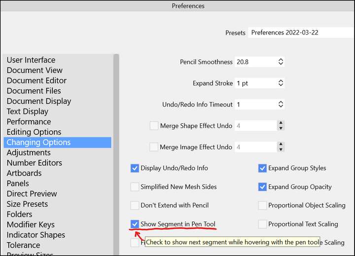

    When the Pen Tool is selected It would be very handy to have the "Show Next Segment" check box on the Context Panel, grouped with the "Symmetric" and "Adjustments" check box.
    Currently the option is under the Preferences > Changing Options "Show Segment in Pen Tool"
    I actually thought that VS did not have this very useful option that is available in Adobe Illustrator and in Affinity Designer (Rubber band mode). Happy to find this available, but it should be more prominent for easy activation/deactivation, like in AD.
    Thank you for considering.

    I think the best way of putting it is: I would switch this "Show Next Segment" mode on and off quite regularly, as my workflow would dictate.
    Both modes are useful for different tasks. I appreciated AD's placement and thought it to be very logical and accessible, but as long as a user has the option to locate it somewhere in the main window, that would be essential and my reason for asking. So Pen Panel or configurable Context Panel, fine by me.
    P.S. give "Show Next Segment" a try next time you are tracing something on an image layer, it can really teach a user elegant node placement for a design.
