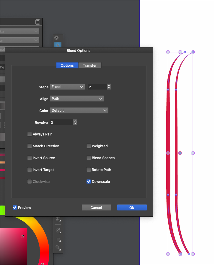

      Are strokes with width adjustments (command-P) unable to be blended? I keep trying to get the preview to work but nothing happens
      0_1648355947994_e911cbff-344e-47b2-853e-d37c5b6f3bf4-BLD 2022-03-27 at 00.38.17.png
      UPDATE:
      ok when I expanded the strokes it suddenly showed me the blend as I had expected
        @Boldline Stroke width profiles should blend. Could this be a refresh issue?
        I tried it here and it seems to be working fine for different width profiles.
          @vectoradmin I saw the new build and upgraded to 26 and tried again, but it's not doing what I expected. Here is the video and the file:
          link text
          0_1648405166582_blend issue.vstyler

            also on 26, win 10, Blend strokes working here

                  @Subpath ok thanks - the reason I ask is because with those strokes, I had used the path width tool and that was where it seemed to give me issues trying to blend it properly afterward
                    Subpath @Boldline
                    @Boldline
                    first observation
                    the two strokes seems some how connected
                    if i hover over the left one both get selected
                    • no regluar blend visible
                    as i copy and paste both the connection seems gone
                    also no regular blend, and if i expand the blend
                    i get only lines
                    also no regular blend i copy the your strokes to new file
                    Here the video
                    attemp with your file
                    in the video the left one is already blended
                    and expanded

                            @Subpath They are connected because they form a blend object already. But since they are so close to each other, the first object is more difficult to select separately (hover the cursor on its left and click).
                              b77 @Boldline
                              @Boldline Indeed this seems to be a bug — if you get rid of the brush contour of both red lines the interpolation works.

                                  @Boldline I think the issue is that these two shapes contain brushes, and it seems that the brush content is not blended.
