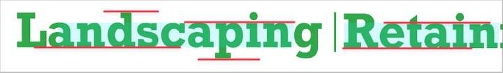

    Working today with expanded text and needing to align them - I cannot rely on the live text to do it with use of the baseline because the text is all vector objects and it will align based on the top of letters like lowercase "L" and the lowest point in letters, like the lowercase "p"
    Yes there are ways to do this already, but it would be nice to have a more automatic and accurate way in the future
    Showing the extremities that can cause it to not align correctly with red lines - and showing a light blue box as a possible way to add a temporary height to align using so VS bypasses the extremities that may not be equal in all expanded words. Perhaps we would need a way to also do this to account for horizontal alignment as well?

    @Boldline There is an open feature request to use the font metric info (various heights) for snapping. I think this goes there.
  • @Boldline It definitely can be done, I guess the more difficult part is the UI for this.
    I thought that just Option-clicking the align button to align the text with the baseline instead of the descent line could work, but what do you do when you want to align them to the top, as there is the mean line (the x-height), the cap line, and the top/ascent line?
    @vectoradmin Successive Option-clicking to cycle through the options?

  • Keep in mind however that since some characters have overshoots (C, G, O, Q, S, U and maybe others go over the baseline and the mean or cap line, depending on the font), converted text has no font metrics and will align badly.
    So it's better to keep text editable (unconverted) so the app can align by descender, baseline, mean line, cap line, etc.
