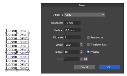

Maybe you already know this, but I would like to point out that
you could also use Menu > Object > Transform > Move for these copies.
@Subpath Thank you for sharing the valuable tip. I was leaning heavily on the distribute functions, but this is way more functional for so many applications. Awesome!

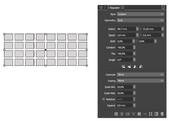

Btw, if you need this kind of distribution then also take
a look at the repeater.
@Subpath Admittedly I didn't even know about the repeater. I am glad you shared this one with me as well. Having this much control over shapes so very valuable! Thank you
