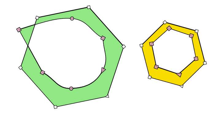

                I created two shapes and did a "Combine" boolean so the two shapes become two sub-paths in one path (green). I also did an "Exclude" boolean (yellow):
                Using the "Shape Editor" (node tool), I selected one node on the inner sub-paths of only one shape (green or yellow), right-clicked and chose "Select All", or just use CTRL+A. The result was exactly what we are talking about. All the contiguous nodes are selected!
                Only one minor hitch...
                • Hitting Delete or Backspace to delete the selected nodes, deletes the entire shape without selecting the nodes on the other outer sub-path. 🙃 ?
                • FYI, both sub-path can be selected by selecting just a single node and hitting CTRL+A twice, the result is both sub-paths are selected.
                So it seems like the spirit of the functionality is already there, it just needs the delete, move, scale, rotate, etc. functionality to work when nodes are selected with CTRL+A.
                Other note: Hand-selecting all the contiguous nodes WILL allow delete, move, scale, rotate, etc.
                @vectoradmin any chance the CTRL+A at the node level could work as a functional contiguous selection mechanism?
