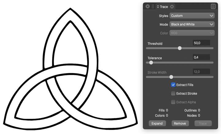

      Here's the original image:
      No tricks. No traps. Black outline on a transparent background.
      Using Mac:
      Super Vectorizer
      0_1649259317367_trefoil_test_trace_SV_SVG.svg
      Inkscape
      0_1649259340895_trefoil_test_trace_Ink_SVG.svg
      Vectornator (AutoTrace) - They aren't any better
      0_1649259377799_trefoil_trace_transp_blk_Vect_SVG.svg
      Didn't post your example because none of the settings I tried worked.
      What settings should I use to get the best possible result?
      And, why is it so hard?

        @fewerjunk Tested the image. Looks like there are some issues in creating smooth curves in this case. I added this to the backlog as a bug.
        Is there a larger resolution image for this example?
        F 1 Reply Last reply Reply Quote 0
          VectorStyler @fewerjunk
          @fewerjunk The best I can get is with "Black and White" mode, and Tolerance 0.4 (all others are default).
          Another option is to use "Extract Stroke", but the joining points are not yet handled well.
              @fewerjunk There is still need for improvement in the image trace.
              I attached the vectors I got with VS.0_1649264673534_imagetrace1.vstyler
