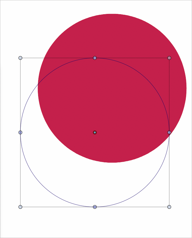

@b77 Here is what happens if I leave a stroke in there when I use divide to divide up the gray shape.
There is left a thin white gap between the two shapesIf I make the same stroke have no width at all, and then try the divide boolean again, the gray shape is not divided at all

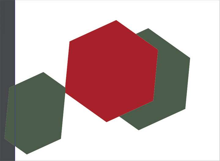

@Boldline How about using the CutOut boolean op. It will cut the second selected object using the first one.
@vectoradmin hanks for the suggestion. I like the tool overall.
That works ok but still leaves a think white line between the red and green in this case... it's not a bad thing for most purposes, but would be nice to have the option at some point for the totally clean cut. There are certain times that method is preferred.
The cut out method still requires a fill shape, and cannot be a simply a stroke.
