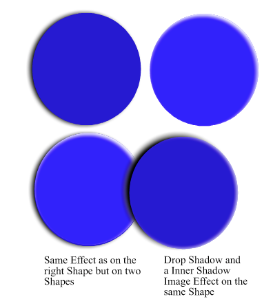

Hi
Here a Short attemp of mine.
You could use one shape with a drop shadow
and another shape with a inner shadow (set the
color to white in the Effect) and put them on another.Or use both Image Effects on the same Shape.
But im shure there are also yet other ways to
do that.

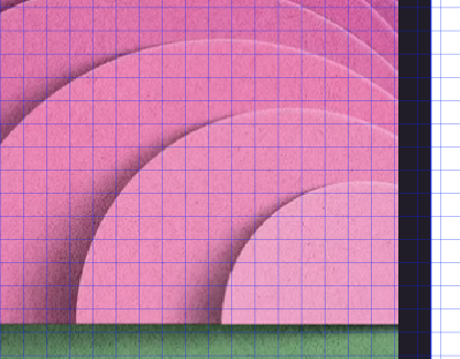

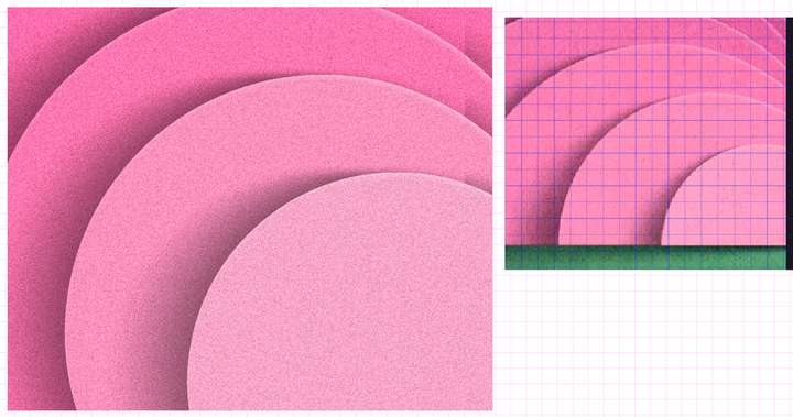

@Subpath you inspired me to see how close I could get. Attached is the Vstyler file for reference, @MajorTom. Look in the Image Effects Panel for the noise, shadow, and highlight values.
@vectoradmin there are some odd shadow lines to the right of the imitated circles. They appeared when I grouped them to crop them with a rectangle. Not sure why they appeared, but when you ungroup them, they disappear.

@Victor-Vector The lines are caused by the clipping. One of the shadow effects thinks it is a margin and casts a shadow from it. I ad this to the backlog and try to figure out a solution.
Meanwhile, as a workaround, instead of clipping, just cover the outer margins rectangles? -
