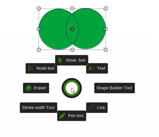

            I have already mentioned many times in various threads that I am testing several applications that simplify the use of the most common commands.
            Currently I'm stuck with two.

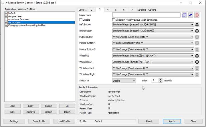

            1. X-mouse Button Control
              A free program that amazingly extends the possibilities of the mouse.
              It allows you to assign any key sequences to them, introduce breaks between them, create layers and a lot of others.
              It just so happens that I use exactly the same mouse model πŸ™‚
              This program allows Button Chords, i.e. pressing and holding one of the side buttons allows you to change the functions of the others. This way, having only 2 side buttons, you have access to about 10 convenient combinations.
              In addition, you can create layers that can be triggered by a button on the keyboard. For example, by holding F3 and turning the wheel, I change the Tracking in the text, and under F4 the Stroke width in the same way.
              I highly recommend it if someone works on Windows.

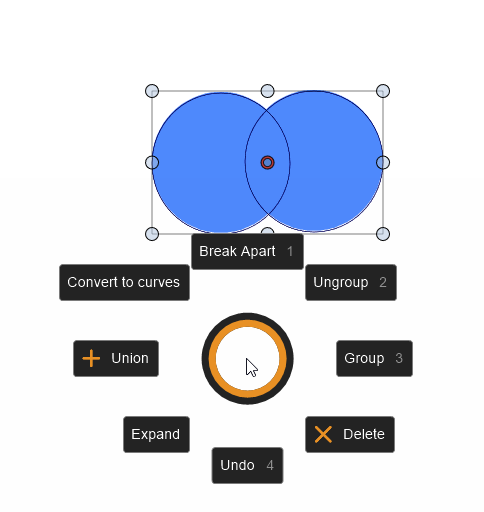

            2. AutoHotPie Alpha
              https://github.com/dumbeau/AutoHotPie
              This is a program that I got using the Radial Menu based on AHK (AutoHotKey). It has slightly smaller possibilities, but better ergonomics and a modern look. The program is currently alpha, but it is stable, but if there is a problem somewhere, it takes a second to reboot.
              It allows you to create a pie menu around the cursor with any shortcuts.
              Calling can be done with a mouse button or keyboard.
              Personally, I try not to assign more than 8 shortcuts to a single menu - then using gestures is pleasant and fast (the zones are large enough to hit shortcuts). I assigned one menu to the side keys of the mouse. One is tools and the other is frequent shortcuts. When it enters the bloodstream, it speeds up the work.
              The only problem I am experiencing is getting out of the text mode that I have already reported.
              I am an ardent advocate of introducing this type of functionality in the VS in the future.
              Sample video: https://recordit.co/W6BrxlaoDu
