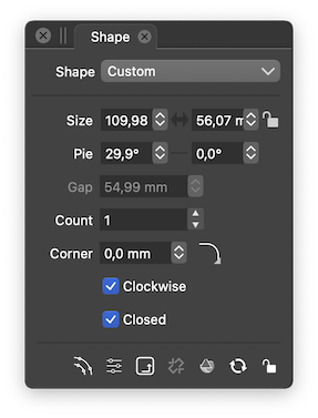

          • IngolfI Offline
            Ingolf @fde101
            @fde101 said in Padlocks for Purity:
            It might not be the most discoverable (unless explained in a tooltip perhaps)
            Exactly and then it will only be used by a small minority in the end. A better usability concept is needed.

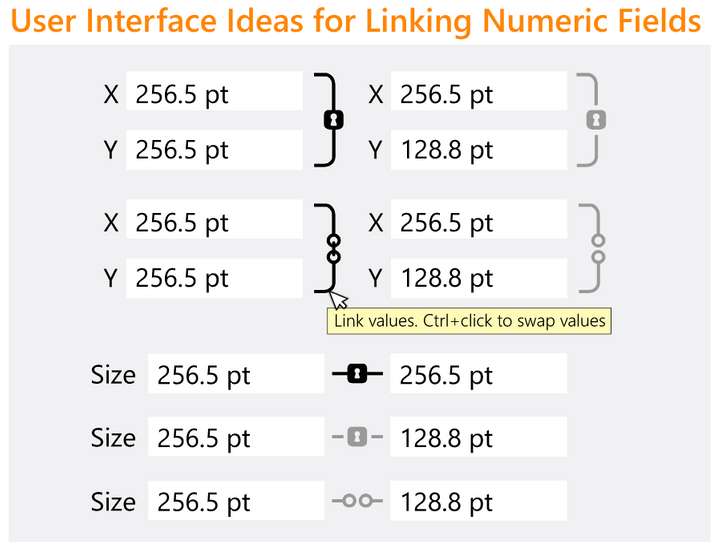

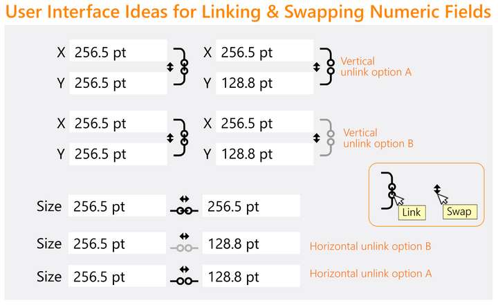

            • Victor VectorV Offline
              Victor Vector @Ingolf
              @fde101, @Ingolf, @b77
              I couldn't help myself from playing with your constructive suggestions. Here is the result of my geeking out.🤓 Handled the questionable use case "swap" with a mod. key and a tooltip, eliminating the need for an extra UI element. I also tried the lock concept as well. Other popular vector software packages seem to favour the links.
              I am in no way married to any of this, merely brainstorming ideas!

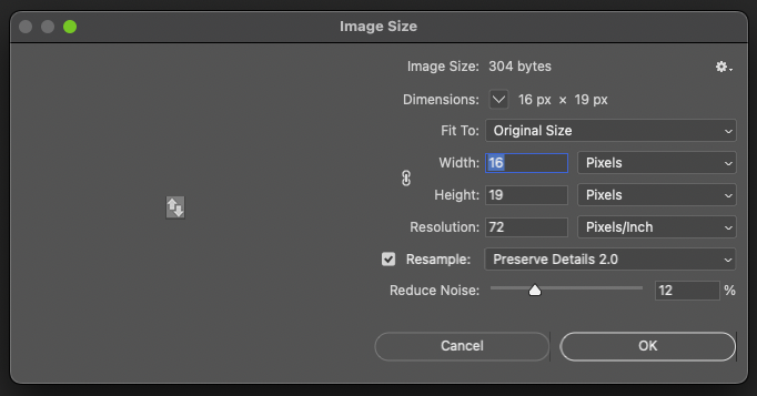

              • IngolfI Offline
                Ingolf

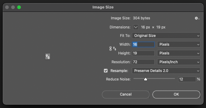

                I would personally go with something widely used and known from Adobe - the minds adores familiar objects:
                With an additional icon for field swapping - with a tooltip I think people would understand - and it is quite inobtrusive in the interface when not activated / in use:
                🍏 macOS Sequoia Apple Silicon
                    Victor Vector @b77
                    @b77 Yes, this idea is a nice solution for both horizontal and vertical, the flip is always between the two numeric fields and the lock/link is always at the right-most end.
                    @Ingolf I do like Adobe's swap icon better than what I came up with. I was referencing both Photoshop and Affinity Designer to look how they represented lock/link. I had forgotten Adobe has a swap icon. Interesting to see how tiny they felt was acceptable for the icon.
                    • IngolfI Offline
                      Ingolf @Victor Vector
                      @Victor-Vector said in Padlocks for Purity:
                      Adobe has no swap icon; the first two images in my post show the existing link fields (constrain dimensions) chain icon. 🙂
                      I simply added a standard swap icon to the dialogs to illustrate how both icons could co-exist wasting almost no screen estate:
                      The real fancy detail in Adobes UI is that the lines are only displayed when the lock dimension icon is pressed. Otherwise the interface is calm and clear:
                      Notice that the standard swap icon I added doesn't attract any unnecessary attention:
