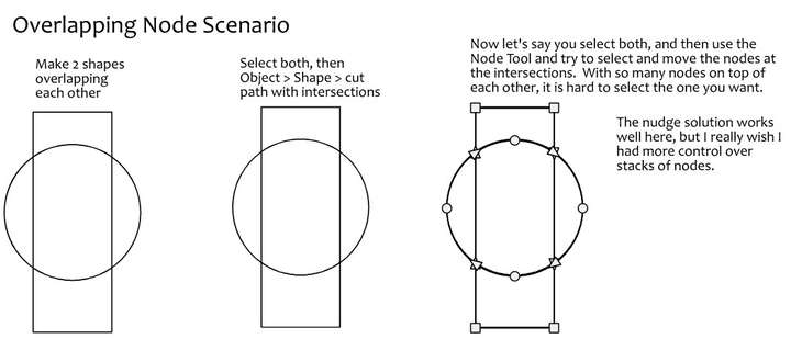

Oh, that was just for illustration purposes. I can give you more of a real-world example where there might be nodes either stacked on one another or in close proximity. More to what @Boldline is talking about trying to select a node underneath a node. Check out this file as an example:
0_1653449050525_Overlapping nodes.vstyler
@b77, @Boldline I like your ideas of using a modifier key with a click-selecting as a way to grab a node underneath another node. Perhaps it can cycle through the node stack with each modified click, like: 1,2,3,1,2,3, etc.?
