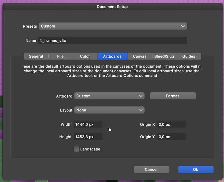

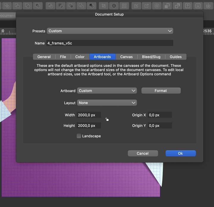

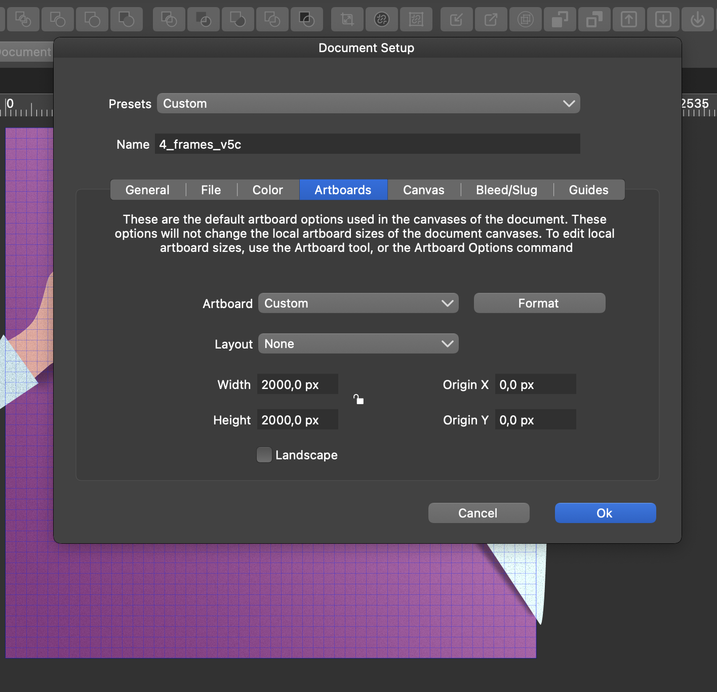

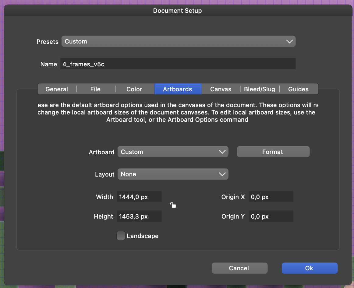

I have several files if I hope the file on the MacBook the canvas size is correct. 2000 x 2000
But on the iMac the size is completely different and the pixel numbers are very strange.
I can close, restart the computer, what ever I do the canvas size stays the same.
anther file is on the MacBook 4000 x 4000, on the iMac 2906,7 x 2906,7 px
I can even save the file on the iMac and reopen it on the MacBook and the size is again 4000 x 4000 on the MacBook.In addition I am not able to export the files on the iMac as an PNG or JPG. The export bar is displayed for about one second and than just disappears without any error message. (==> sorry the attached file below does not have the export problem, it is the 2000 x 2000 file, but that's too big to be attached here.)
Below you can find attached the 4000 x 4000 vs 2906,7 x 2906,7 px file.

@MajorTom This is not caused by a settings, but by the screen resolution of that computer. Internally, sizes are always stored in points (72/inch). This is converted to pixels in the UI only, using the current resolution. On different computers resolution is different, so I get different pixel count per inch.
