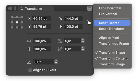

@badcat To reset the pivot, choose 'Reset Center' from the options menu of the Transform panel:
You can also drag it with Option-Shift, which lets you move it back to the center of the bounding box.
I don't think numerical positioning of the pivot is possible atm.
