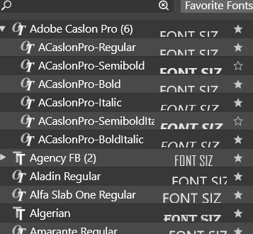

Hi, I have 3 questions:
- Can I fix the font preview size in that selector?

(1) The first issue (font preview) seems to be a Windows-only issue. Here it is properly centered.

It may be a Windows issue, but it's impossible to determine the font

@plrang said in 3 questions: font selector, scaling, control nodes:
There seems to be no option to control this, and from the screenshot looks like a bug.
I added this to the list of bugs, will be fixed ASAP. -
