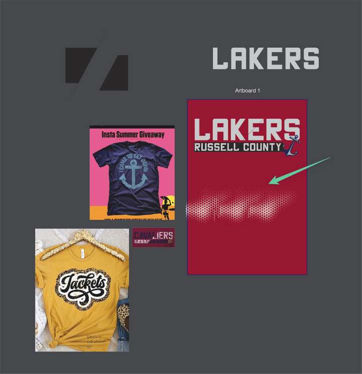

        @VectorStyler I went ahead and sent you the big file - it's 15mb in size. When I open it, the RAM usage jumps from under 1GB to over 3GB. I'm sure it's related in large part to the triangle pattern I imported and ungrouped and was editing. It still seems like VS should not be getting bogged down, despite the file size...
        Here is how the screen looks and I put an arrow pointing to the ungrouped vector pattern

            @Boldline I got the file and tested it. This could be a performance bug.
            3.5 GB is quite a lot, but it can happen. Still it should not slow down that much.
            One way to reduce RAM usage is to purge the Undo/Redo history (and maybe then restart VS to have a clear state).
            But this does not explain the sluggish behavior so I open a bug on this one.

              Did it jump in RAM usage for you as well and turn somewhat sluggish when using that file I sent?
                @Boldline Yes it also consumed 3GB here. But it reduces if the Undo/Redo history is purge.
                Could not yet get to the sluggishness part.
                Was it caused by moving the halftone vectors? or some other part?

                  Yes, it was when I was trying to select a vertical portion sample and use option/alt to copy and drag it down to lengthen the vertical number of them - it would just freeze up for a few min
                    @Boldline It seems to be working here (could test on an Intel Macbook Pro for now), if I select parts or all the halftone vectors, duplicating works without slowing down.
                    If you have time to make a recording, I might be able to find the issue.
