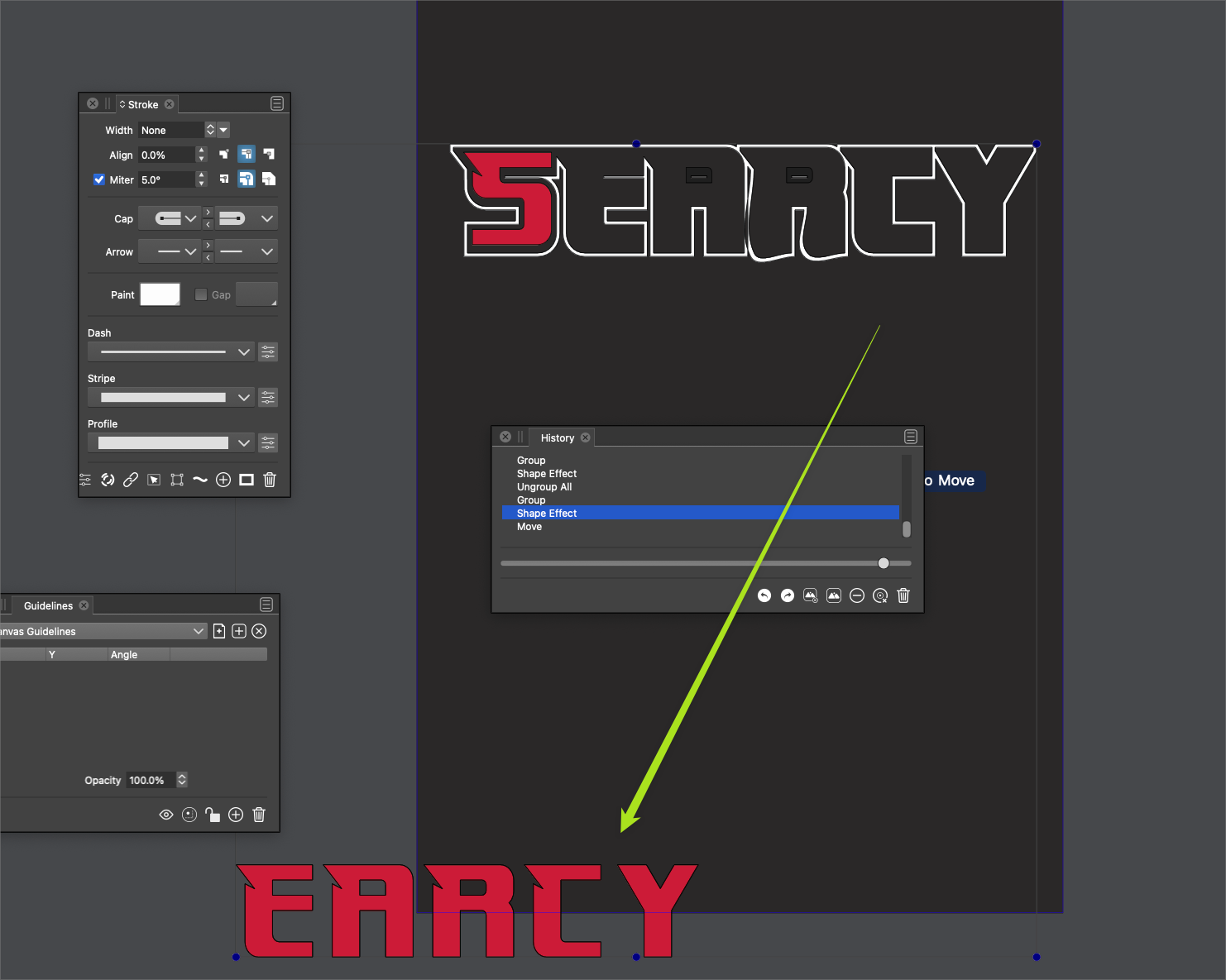

      I created this wording art completely in VS. Wen I attempt to warp the text, the "R" produces an unwanted result
      0_1657045296070_596990ad-cf52-42e0-b938-86e88cdcd27e-BLD 2022-07-05 at 14.19.31.png
      here is the file I was using 0_1657045348468_warp issue.vstyler
      UPDATE: It also now seems to want to throw the parts all over when I ungrouped it before warping to test if that would work:
      0_1657045479892_61c55e6e-d90a-4071-a9cb-5ee4c5788f51-BLD 2022-07-05 at 14.23.41.png

        @Boldline The first part looks like a bug. After expanding the text, the nodes at the line endings are of smooth type, which should not be (for lines). This causes the effect to adjust them to be actually smooth.
        workaround: select the nodes in the expanded text and set them to cusp.
        This will be fixed in the next build.
        Could not replicate the second part. How was the warp added after ungrouping?

          @VectorStyler said in Expanded Text grouping creates unwanted result with warp tool applied:
          Darn! I didn't save that result after it happened - this was when I restarted VS entirely and things seemed a little better. I had just ungrouped the selection of word art and then tried adding a warp to it and it spread all over... it's not doing it here now after restarting VS.
            Ok this makes sense now - I'll keep that solution in mind if it happens again. Glad it will get fixed in the next build - thanks!
