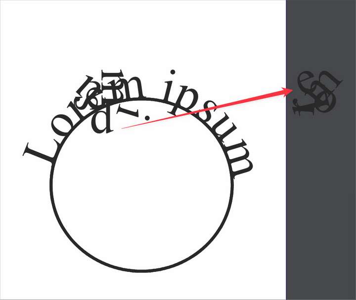

      I was looking into the new options for text on a path - having two on one path and ran into an unexpected error.
      If I create a normal text on a path with an oval - it works fine. If I copy and paste that oval and text and paste it overtop itself and then try to move the text along the path using the text on a path tool, it refuses to budge. If I move the copied text and related path off to the side from being overtop, sometimes the original is gone (can be seen in this video) and other times it remains... If I move the text around enough, it goes off to the side and gets bunched up in a box of it's own making... you can see that in the screenshot below and in the video

      0_1658235184406_030da9c1-98e8-4aba-993c-74f8747d266b-BLD 2022-07-19 at 08.46.11.png

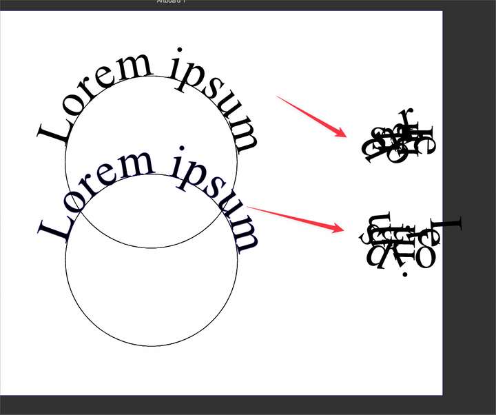

              I'm still seeing that secondary issue however, where the text bunches up in a box off to the side like in the first example...is there a reason this is happening?
              0_1658241159767_8014b4d3-d944-4b07-8771-03ea17d928cd-BLD 2022-07-19 at 10.32.23.png
