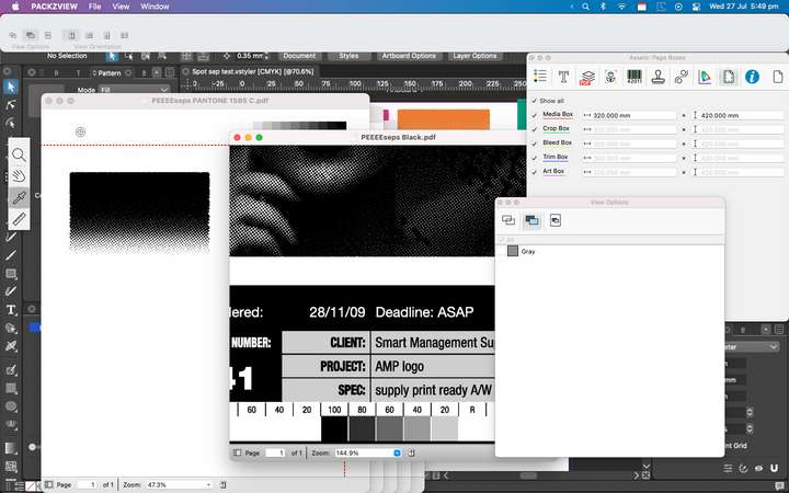

                            Wow you really are a true genius --- 7 separation PDFs produced, now working great👍 👍 👍 0_1658940832084_Screen Grab 2022-07-27 at 5.49.58 pm.png
                              Boldline @Dazmondo
                              @Dazmondo Amazing! Awesome job persevering and sticking in there with it all. I want to echo his compliments to you @VectorStyler - you are indeed a genius. I'm impressed so often by what you figure out and solve and how quickly you make it happen
