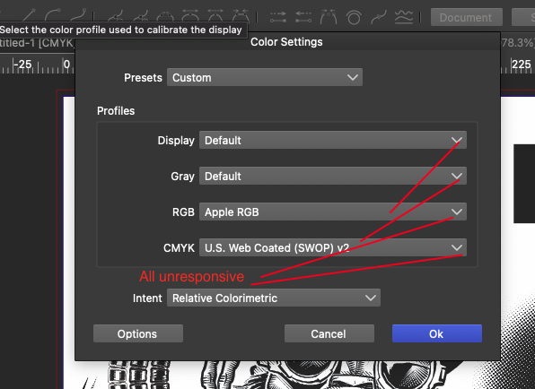

Unable to change colour profiles
In colour settings, the profile tabs appear to be locked for me and just unresponsive - is there any way of re-gaining access to colour profiles?
@Dazmondo yes, this happens here too, and it is a regression.
As a workaround, go to Preferences -> Folders and in the "Folder Mode" drop down select "Color Profile Folders", then "Add Folder" and select where the color profiles are. -
@VectorStyler said in Unable to change colour profiles:
As a workaround, go to Preferences -> Folders and in the "Folder Mode" drop down select "Color Profile Folders", then "Add Folder" and select where the color profiles are.Brilliant stuff
