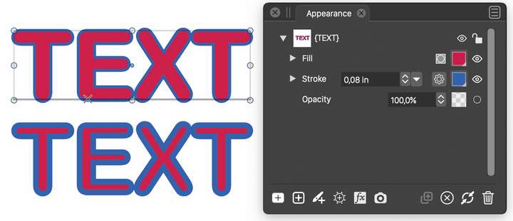

          The workaround could be to duplicate my entire text layer when I'm done and give the bottom layer the stroke while leaving the top layer untouched. But it's surprising that this isn't working as in AI. The attributes in the Appearance Panel seem to be selectable but I can't get them to actually move or change hierarchy. Is this a glitch on my end?
            VectorStyler @jfraze
            @jfraze I tested with the Appearance panel (on Mohave) and the stroke can be dragged under the fill for a text.
            Here, the two text objects are exactly the same, except the top has the stroke below the fill as shown in the appearance panel.

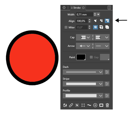

            Aligning the stroke is probably not the best solution for this case.

                i test it, it works as @VectorStyler descriped.
                Here a Video

                  @Subpath That's exactly how I would expect it to work. But it doesn't do that for me. Dragging just leaves things in exactly the position they started in. I've tried restarting a few times, but no joy.
                    @jfraze Can you send me an example file where Appearance dragging is not working. I'd like to elliminate a couple of possibilities.

                      0_1659805932329_test.vstyler @VectorStyler I don't think it's in the document, but something to do with my installation. My suspicion is it's going to work as expected on your end.
                        @jfraze It is a bug! when editing the stroke / fill on a text selection.
