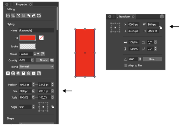

For straight lines and rectangles these Panels may be helpful.
Panels > Properties
and Panels > TransformBoth have a Width and Height field
where you can enter the desired length, size

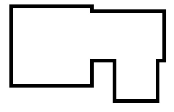

I have already made some experiments with floor plan drawing in VS.
Here is a method that works via Live Boolean Union
and allow some live editing.
@Subpath said in Document Scale:
Yes, I use these ALL the time when creating stuff and you can certainly dimension large objects and grids (I tried a 100m square), but having a document scale means that it will fit on a bit of paper to print on - TBH, that's probably the only benefit

Yes, that's a useful method - probably better than drawing with double wall-width lines on a grid .
