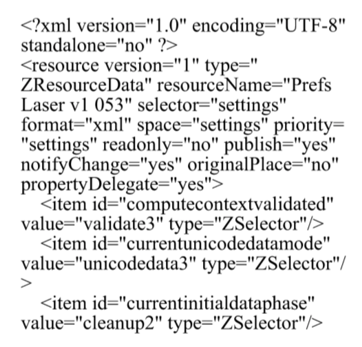

                I just did a restore defaults for the preferences and this issue has disappeared. However, when the app restarted , this (looks to be XML) text was on the front of the document I opened ...
                When I reload my preferences from file, the issue appears again. I can email my prefs file if you want.
                    What document was opened. Send it to me by email. This looks like the starting of the preferences file.
